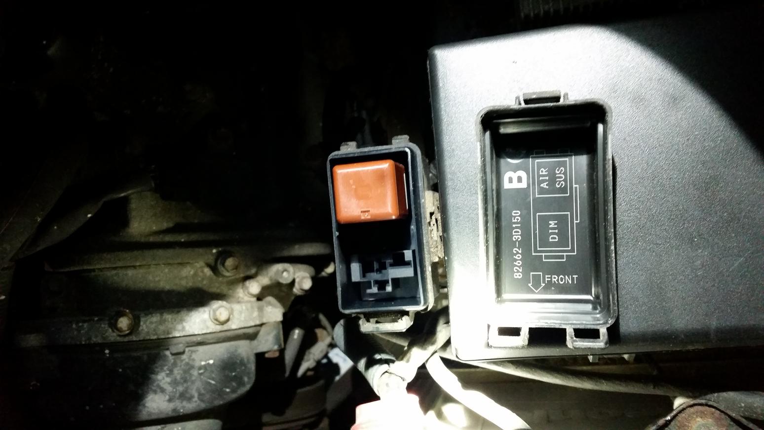

my compressor keeps running anyone know what fuses i need to pull to kill it after i did the conversion
Did you pull the sensors for the sway bar links? Once you disconnect those it will kill the system and flash the off light below the indicator.
There are two relays in the fuse panel under the hood for RAS, you need to pull those to disable the compressor. There's a harness behind the drivers side kick panel that can be disconnected to get rid of the dash light - don't recall which it is off the top of my head though.
i didn't pull the sensors i thought that if i left them in place i would avoid the light issue. so as it sits the light is not blinking but the compressor is running constant. the sensors were cooked. so i guess i will pull the sensors and the relays. am i missing anything else?

Disconnecting the Ride Control Computer, Fuses and Relay if you’re adding a lift to your GX470/4Runner.
3.1 Inside the engine bay you will locate the fuse/relay box on the driver side. One the inside of the panel will have a chart showing the location of all the fuses and relays. Locate the “Air Sus 50A” fuse and the
“Air Sus Fuse #2” and remove them from the fuse panel.

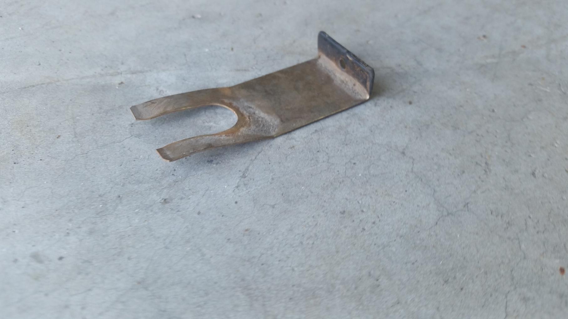

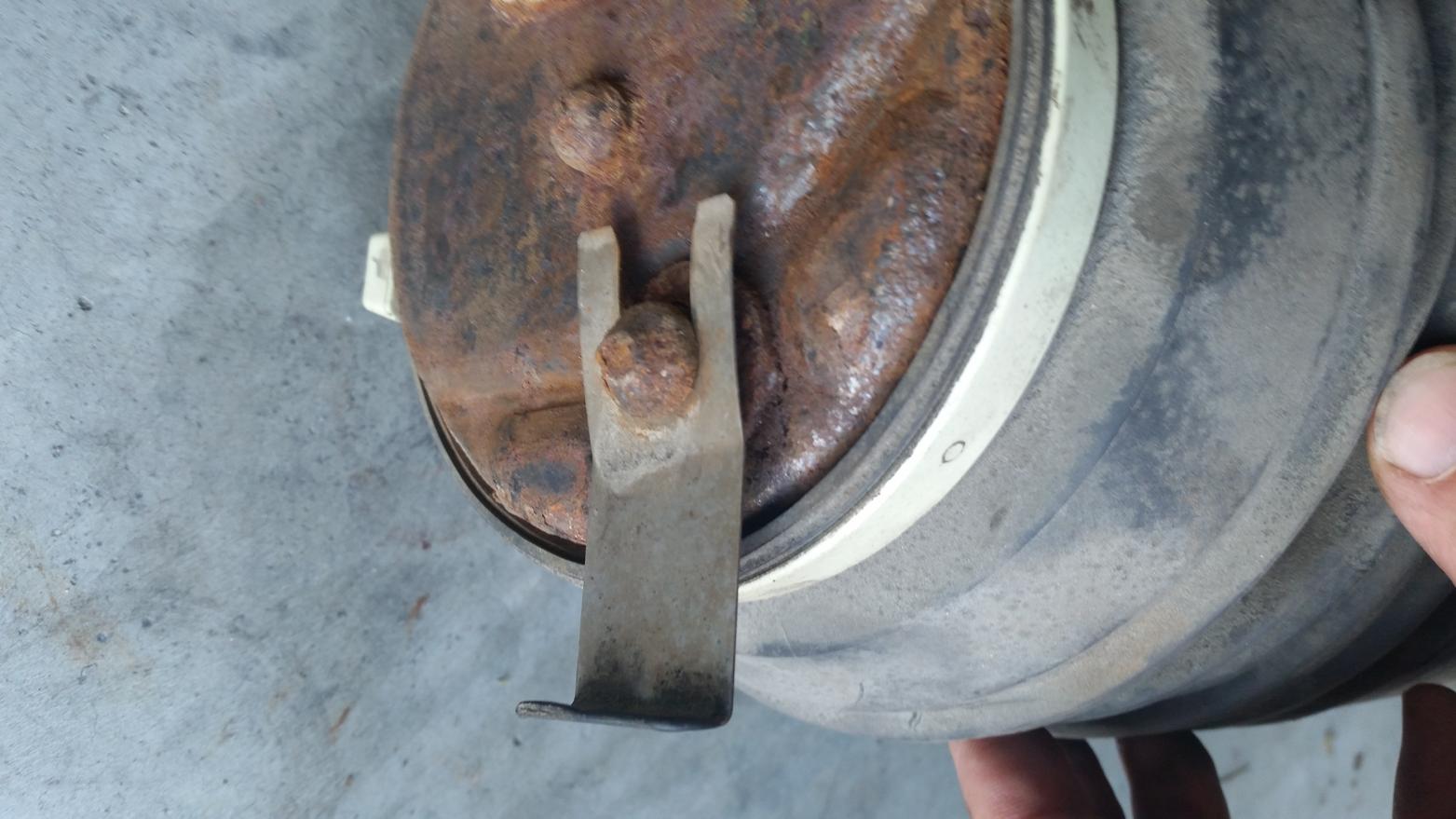

just so everyone can see the clips on top of the airbags like the instructions say it is quite tight in there to grab them and it is hard to see them
