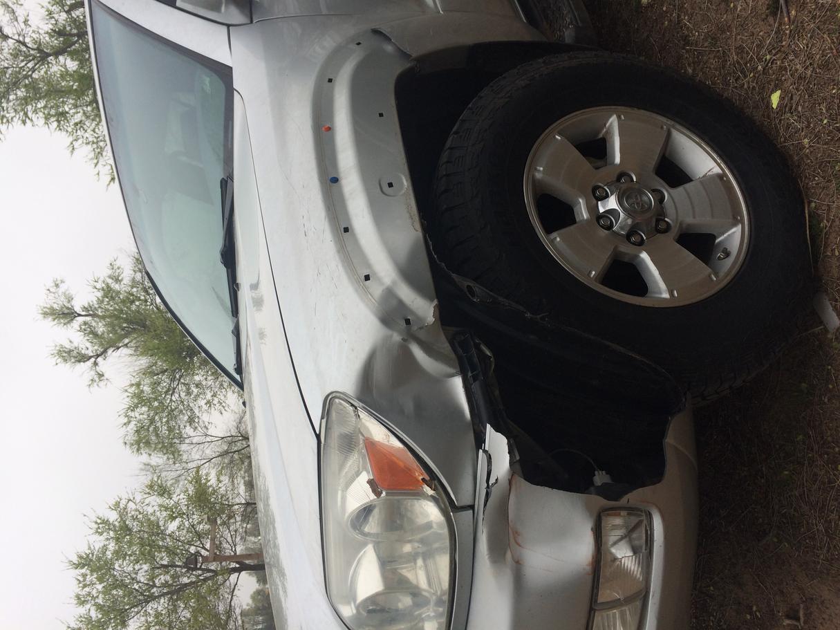

Well after a good rain and playing in the mud I'm in need of some help. :ybrick: Slid off the road into a fence post and not only busted the side of my bumper off, but broke the fender flare and put a nice big dent in the front fender that I'm about 90% sure I can't pull out and make look decent. Being that I can pick up a new front fender for about $50, I'm looking to go that route, but I'm not finding anything on here detailing how to replace it.
Anybody ever do this? I can't imagine it being that difficult, but I was hoping to find some reading material/diagrams to help me get an idea of what I'm getting myself into.
Here's a pic of the mod I did...I don't know how to rotate or downsize but you get the idea...

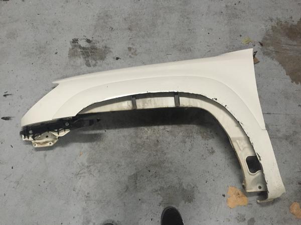

There's a lot of clips and bolts and screws, but it should be straight forward. At worst there might be a couple spots where body seam sealer was used and you have to cut that away.
bumper, fender liners and headlights need to come off/out of the way and then a handful of bolts along the top of the fender under the hood and one or two threw the door jam

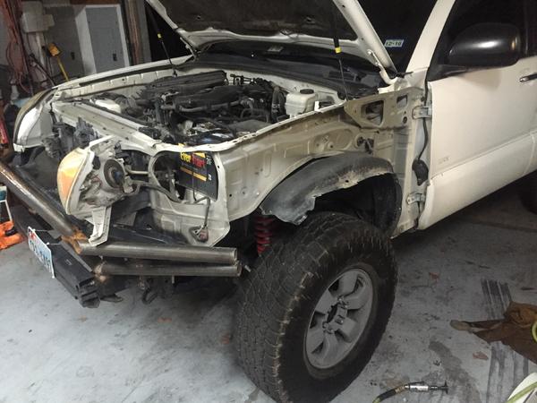

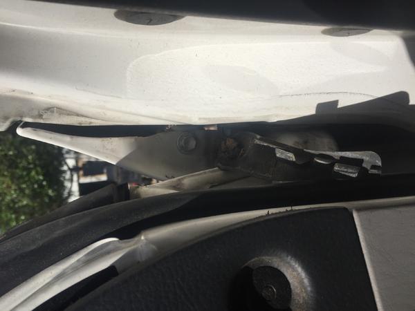

no body sealer just about 7 or 8 small bolts and 2 nut in the front of the fender that bolts to one of the bumper supports. Hardest part of taking the fenders off I can see is the bumper cover or getting the fender liners off, I tried using the proper tool to get the fender liner push fasteners off or what ever they are called with no luck or patients so it got a die grinders with a cut off wheel and was done with it but I was taking my fenders off to cut them and the flares so I had no intention to try and save them. I'm also not sure if you need to completely take off the bumper cover to get the 2 nut and 2 bolts, but mine was already off when ive had the fenders off.

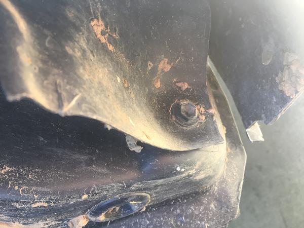

Also after looking I found alother bolt at the bottom back of the fender that is covered by the flare

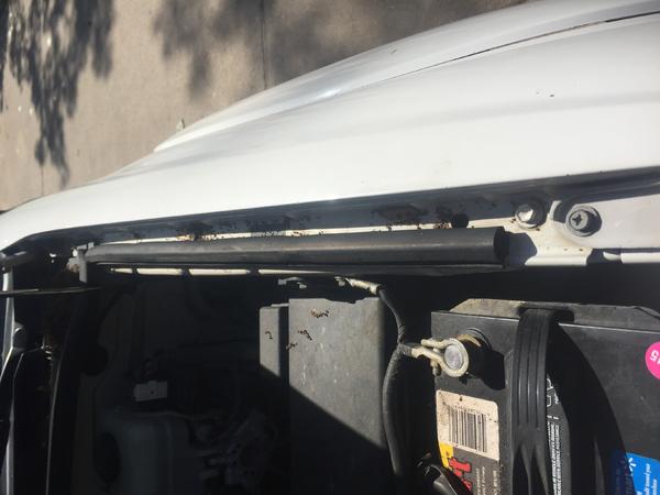

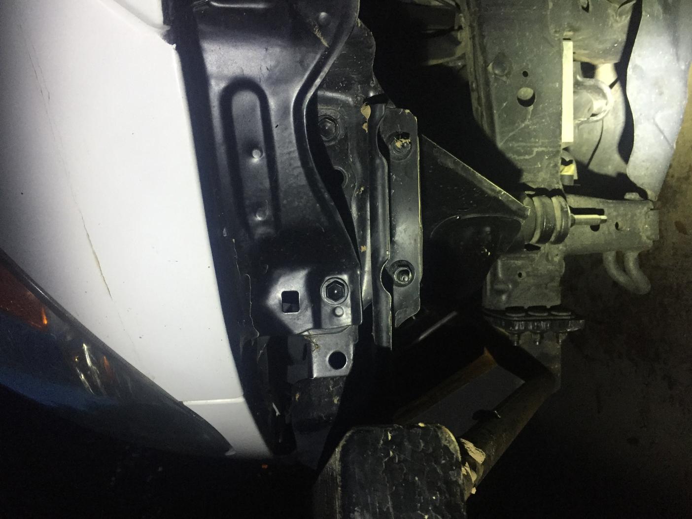

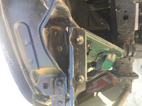

After you get the headlight out you will have 3 bolts up top on the fender under the hood. Next open your door and at the top of the fender you will see a rubber flap pull the top out to reveal a hidden bolt. Under the flare is another bolt, cant remember if you can get to this one with the liner out of the way or if you need to pull the flare off to get to it. The other two bolts and two nuts are at the front of the fender where the bumper cover meet up with the fender.
This is everything to remove the fender that I can recall when I took them off the first time.
