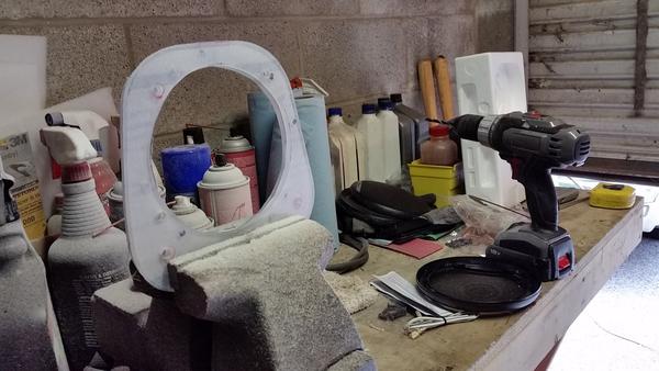

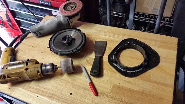

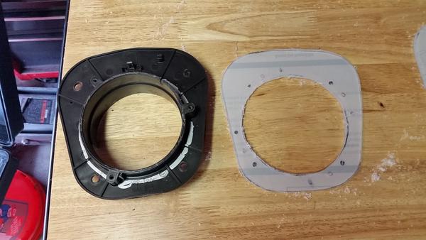

I used the stock plastic mount as a template to trace out the shape and location of the mounting holes onto a piece of 1/2" thick acrylic sheet that had on hand. I used a jigsaw to rough cut the 2 adapters, then used the mounting template from the speaker box to locate the new inner hole. I made a 1/2" hole inside of the new hole in order to have a place for the jigsaw to start cutting.
I then stacked both adapters and gently clamped them into the vise, then used an electric drill and a big sanding drum to shape them both the same and to have the inner holes the same. I think I got this sanding drum kit from horrible-freight years ago. It comes in handy every once in a while.
Be sure to wear a respirator when doing this, the dust is very fine and it very bad for you if it gets into your lungs.

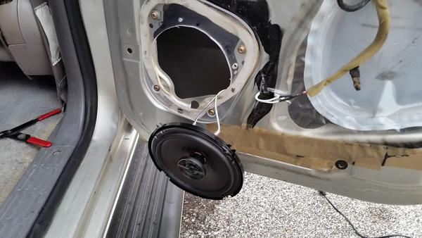

Once the adapter plate was bolted up on the door, I used the new supplied leads from the speaker to pass under the vapor barrier because the new speaker has the connection terminals facing inside of the door now. I snipped the plastic connector from the stock harness and soldered and heat shrink tubed the joint for protection. It's my own personal opinion that the crimp style terminals should never be used, they make horrible connections and they are not water proof and it just screams "amateur hour". It takes so little extra effort to make a nice solder joint along with a bit of heat shrink tube insulation. You'll never have a failed connection once you learn how to solder correctly.
That got me to this point. If you look closely you can see the heat shrink tube insulation, I had black on hand.

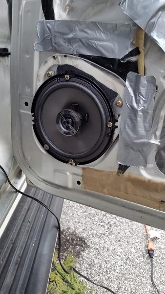

I then held the speaker in place and used a battery drill with a 1/8" diameter drill bit to drill the mounting holes for the speaker. I just made a quick mark on the adapter, then stuck the speaker to door to get it up out of the way ( it has a big ass magnet in it, use it to your advantage !)
Once the holes were through drilled, I held the speaker back up and used the stock screws ( 3 of them) to secure the speaker. I dug through my box of old VW hardware and found some interior screws that would good enough to hold the speaker in the 4th spot. ( did I mention that I'm a hoarder? I don't throw anything potentially useful away. ) That got me to this point.
Some duct tape to secure the harness to the vapor barrier, and I was done. I powered up the stereo to verify everything was working. It was, so I just put the door cards back on, cleaned up my mess, accounted for all of the tools and closed up the storage unit ( AKA " the shop") :wow:

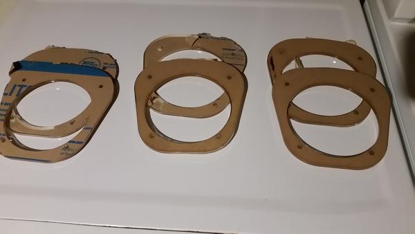

I showed a pic of my home-brewed adapters to a good buddy that has been letting me use a parking lot space at his body shop to do most of the repairs to my runner, he has a '98 (?) as well, and one of his employees just got a "slightly" banged up early 3rd gen to fix/drive, so there's a good collection of old 4runners.
Anyway, he expressed an interest in a set of adapters, I just wanted to do a better job than my own hacked out mess, so I used the OE speaker mount for dimensions, then made a Solidworks model that I generated a .DxF file from. I went to my local Maker Space and fired up a laser cutter.
I was able to squeeze out 9 of them from a 24" x 24" piece of 1/4" thick acrylic. I first tried using the polycarbonate that I originally used, it would just "heal" as soon as the laser made it's pass. I tried adjusting speed settings buy couldn't get it to cut. I just charred the heck out of it, so I grabbed the acrylic and got busy.
I gave a set to my buddy, and now I have 3 sets left over. I'll sell them to anyone that might be interested. I'll look up what the rules on this site for posting up a sale. I'll move to the classified section if I have to.
