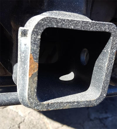

How to fix minor rust on hitch receiver?
alext72888
Don't know how it got there, also don't want it to spread. I know it's minor...
I'm guessing just seal it and it won't spread or should I wire brush/sand the rust off then paint over it with something?
Which product should I use to seal or paint it?

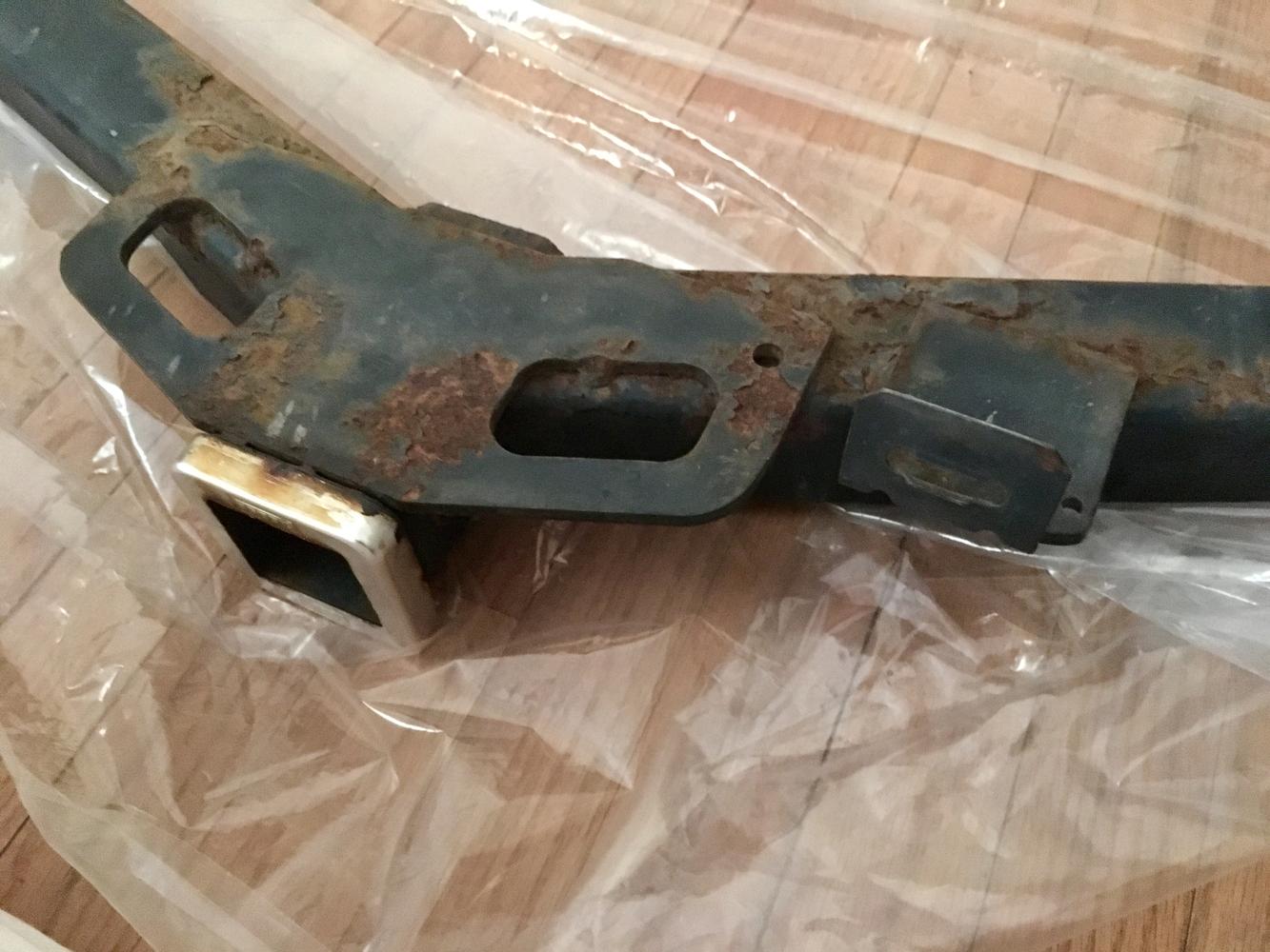

Here's what I pulled off yesterday after spending just a few years in the Midwest:
If you use your hitch it will get metal/metal hits and lose paint. Swapping out receivers, hooking up to trailers, etc.
It will rust.
If you can't handle the sight of the rust, pick a brand and color (Rustoleum flat black, for example) and buy a few cans. Sand off the rust, then lightly sand the rest of the receiver and paint it your preferred color. Then every time you ding it inserting a hitch all you have to do is grab a can and re-spray.
