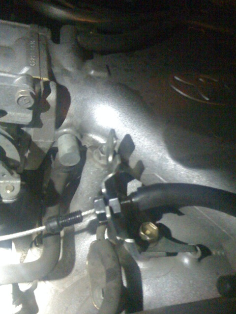

Issue:
Went to do this, and the throttle body "tightening mechanism" that the two nuts sandwich against broke.
I got both nuts to go on one piece of the threaded bolt, but am worried about the consequences.
Now what? New throttle body cable????

Post a picture?
So, you can see that a majority of the "bolt" is broken. For reference, this is the throttle body (item 2 in previous posts). The left nut has a few threads keeping the cable in place for now, but it's much looser than when I originally started.
HELP!
