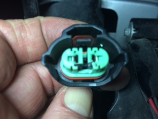

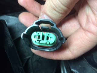

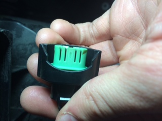

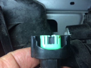

Alternate method for 9005 to 9011 Conversion
It made me nervous to break/cut the socket tab out so I decided it would be easier to modify the plug. Just break off a small tab (green plastic) on the top of the plug and the bulb base wont need any modification. The socket leg will still need to be cut off.
Here are the pics. The last pic shows the cut leg tab compared to the uncut tab.
No wiring problems. I've been running this conversion for two years so far.

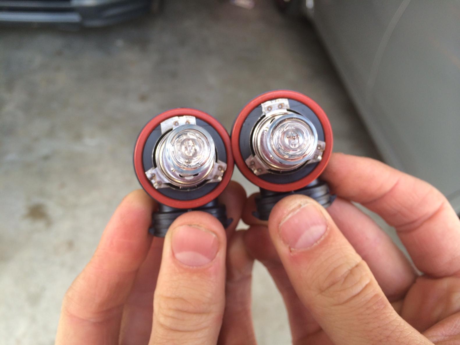

Had my first burn out last night. Was able to go to Auto Zone and pick up a Phillips replacement for 16 bucks after taxes. Modifying the bulb is really easy. I just used my pocket knife to cut the plastic rib out, and my pliers bend the extra metal tab part until it fell off. Entire process took about 20 min including re-installation. The drivers side is really tight and it can be difficult to fit your hand behind the bulb. I have been really happy with this mod. If you don't think it makes a difference, take the vehicle out on a dark road before and after the mod, you can't determine anything from simply shining your headlights on the garage. IMHO there are very few mods that cost $30 and return this type of performance boost.
