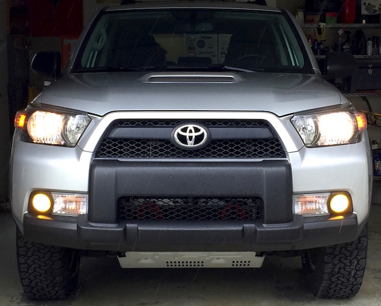

I was a little skeptical about doing this conversion but after some long night drives from Wisconsin to Tennessee, I was tired of the dim yellow light of the low beams. The original bulbs were Osram H11. I replaced with the basic Philips H9 since I couldn't find anything like an Extreme Vision or Nightbreaker. Anyway, the difference is significant even in daylight. The driver side has the H9, H11 still on passenger side. The light is whiter and definitely brighter from the H9. Can't wait to try them out at night.:thumb:
