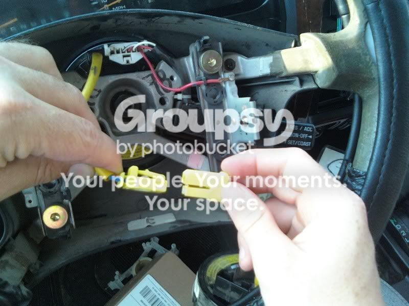

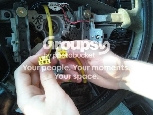

Thanks KBall. The clock spring I installed came from a 1996 T4R. The only difference from my 1998 was the clip for the airbag. I simply cut wires and spliced on the 98 clip that I had from my broken clock spring. It pays not to throw stuff away!!!!! LOL!!!! See Pix. The 96 clip is on the left.

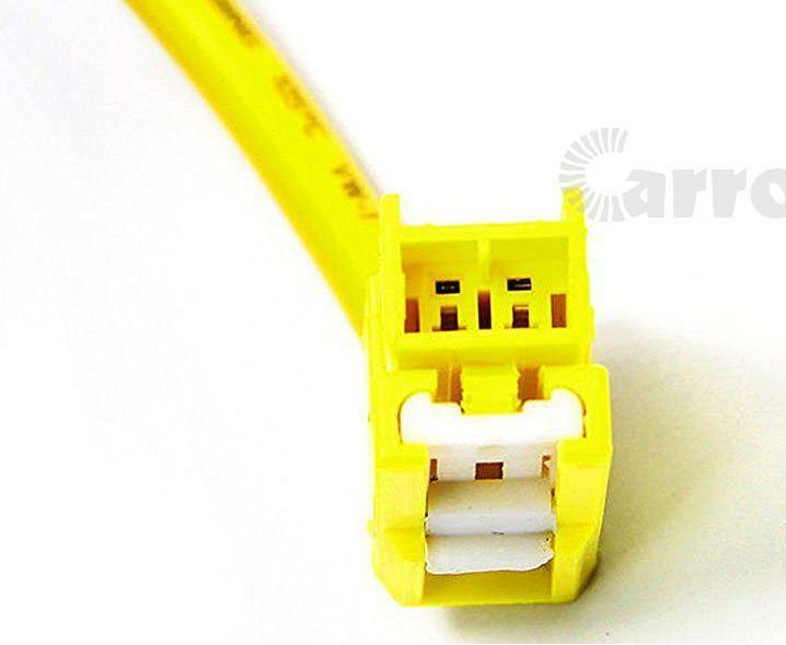

Sorry for reviving this old thread, I'm looking for the right clock spring to fit my 96 SR5. ToyoDIY says I should get 84306-35010, but when I look at pictures on ebay (attached) it seems to show the same clip as your 98' on the right... Which wouldn't fit my 96' airbag right?
