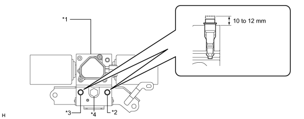

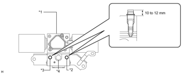

Just finished reading all 19 pages and maybe I missed it, but do you guys not undo the shutter valves when doing suspension work?
Here, the shutter valves get backed off 3 turns whenever anything is done, even installation of a bullbar. Maybe you're doing it and it's an unwritten rule? But we don't tend to use a ratchet strap with our installs as once the valves are backed out the pressure is no longer an issue.
Where’s “here?” It’s not an unwritten rule - most on this forum would argue it is unnecessary and can lead to a costly mistake. I know there’s a process in similar systems (Lexus, Landcruiser) but for whatever reason there’s a big push away from touching that hydraulic shutter valve.
Now if there was a service manual procedure, and some examples of it done easily and successfully, you might change some minds and hearts here. My buddy does it on his LC, and I know there’s an Aussie video I watched that seemed simple. I won’t during my install since 1) it’s not necessary and 2) if I count wrong I have an expensive repair coming.

Now, that is a procedure from an aftermarket shop, not a Toyota FSM or similar. It is the same as I’ve read before, so I think it’s a legit procedure but again I think a lot of folks would like a document from the source, if you will.
Do you know if this allows you to more easily remove the sway bar ends from the LCAs and re-install, or allows you to leave the bar completely in place when you swap out coils?

I don't know the answer to your question. I'm reading this thread to prepare for a lift in two weeks. Toyota's service manual procedure for opening the valves involves measuring valve bolt height as shown below.

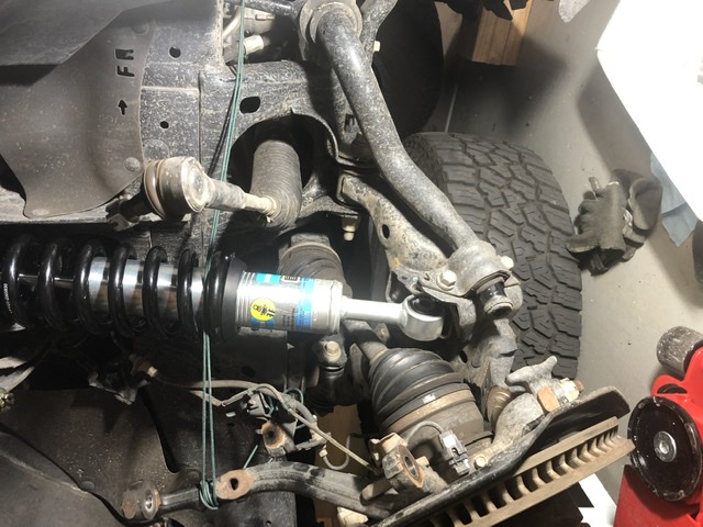

Just finished the 6112/5160 install last night. Will do a little detailed write up but just wanted to shout out that - for the fronts - I didn’t disconnect any part of the KDSS system. I had the 6112s on the 4th perch (2.25” roughly) and was able to remove the stock shock and insert the new longer 6112 WITHOUT a prybar, a center punch, or a second person. Made it incredibly easy. I found KING instructions and noted their big bold warning “DO NOT DISCONNECT KDSS” so figured it was worth a read. The attached picture shows the 6112 sitting in the tower, no lower bolt in place, all KDSS bars and brackets attached, no prybar holding anything down. It’s just chillin...
