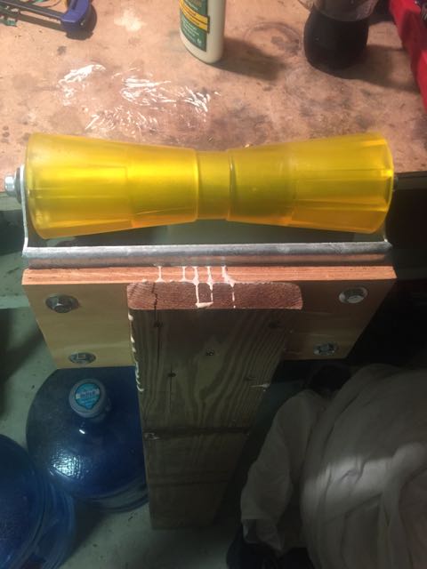

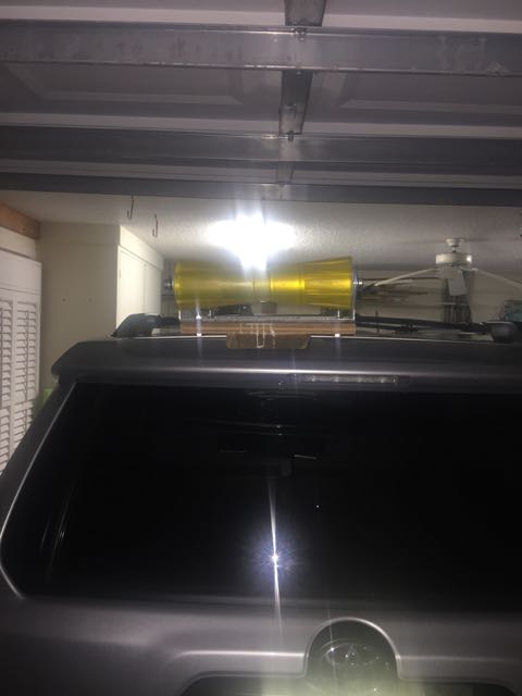

Ive decided to make a contraption using a trailer roller fastened to a board.
The board would tuck under the rear crossbar, and it would extend the roller over the edge.
In theory this would allow you to lean the kayak on the roller, then lift the other end onto the rack.
We'll see when I actually try it.
The problem is that my kayak weighs over 65 pounds, and probably more when wet and has gear on it.
Its not the weight, but trying to balance that weight on a 13' kayak with 2 hands. Makes it a bit difficult to find the exact axis point.

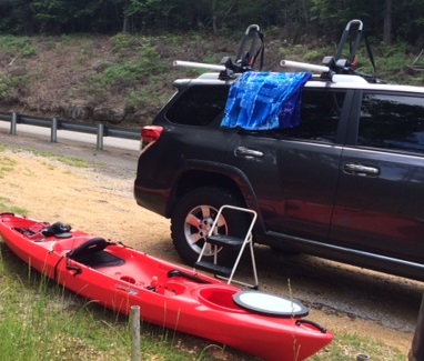

If you can swing it financially, I would recommend going the Hullavator or even trailer route. I can honestly say having to lift 2 70 plus pound kayaks onto the roof deters me from kayaking some days (bad shoulder and just lazy sometimes). If I was not 5'7 and/or had someone bigger than my 12 year old helping me load I might feel different.
Here are pics of my current setup (Yakima with custom Alabama loading extensions-otherwise known as PVC pipe slid over the ends of the Yakima rods). I lay a blanket over the vehicle to protect it (put something thicker than you see in the picture-I have two nice creases in my body from sliding the kayak against the Runner even with a blanket). Leave one end on the ground and slide the other onto the rear PVC pipe. Next, lift the end on the ground up onto the front pipe (Note: The kayak will slide easily on/and OFF of the PVC. Also, if you are short like me...note the step stool). Then, center up the kayak and slide it onto your yak mounts.

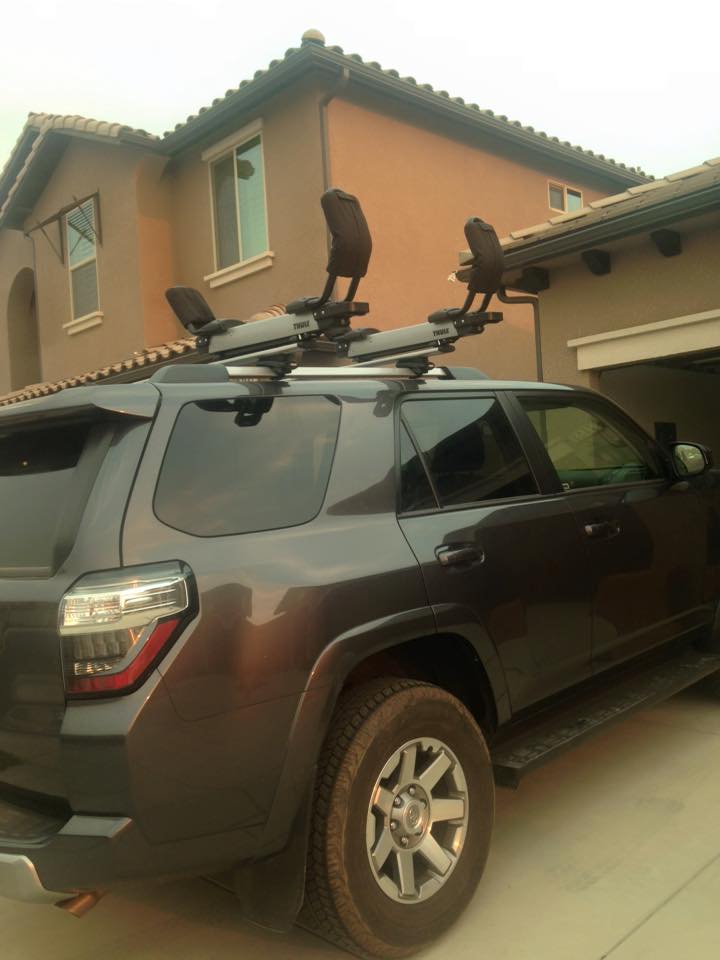

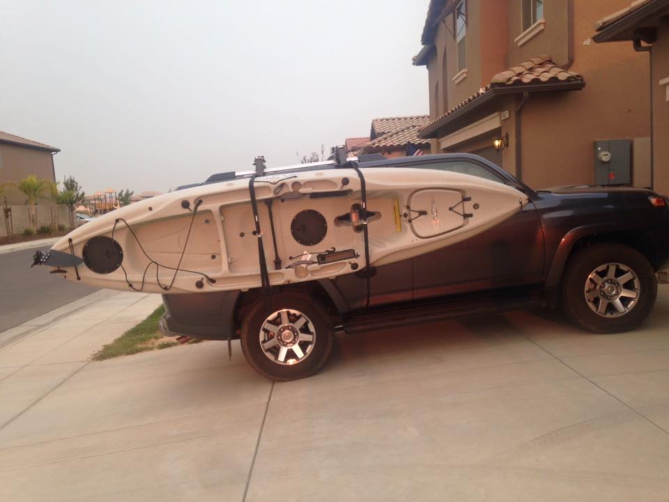

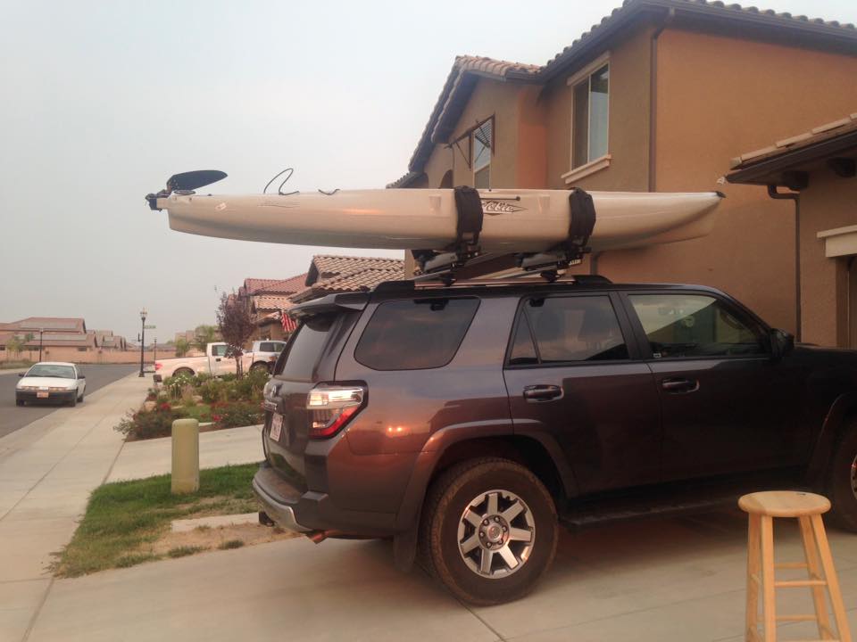

I just finished installing the thule hullavator pro 898. Once the kayak is on the hullavator, its a piece of cake. Since the hobie outback is 80 lbs, lifting it up 3 feet was still a task!! I have to start working out or something, haha.
Overall, I can't imagine loading it up onto the roof the traditional way. I'm sure its doable. Good thing I didn't get the Pro Angler 12 which is 105 lbs yikes!!
Maybe I should have gone with a trailer right!! the crossbar plus hullavator is up there to almost the price of a trailer, haha.

Well, after some experimenting and brainstorming, Ive come up with a solution.
I am doing the final build tomorrow and will post pictures and details.

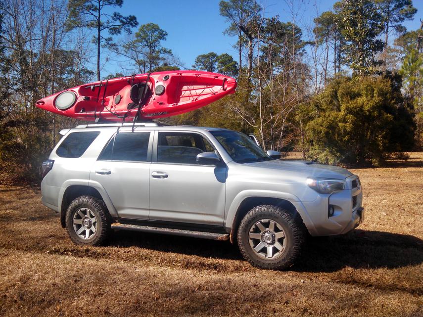

cheap J cradles for now, until I can find some hullavators at a REI garage sale.

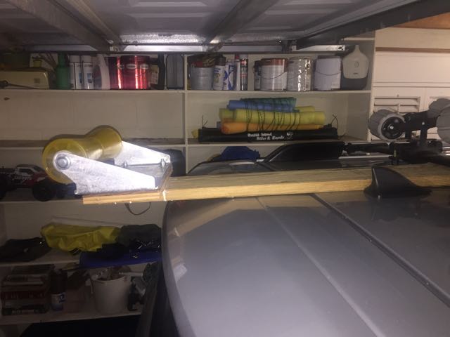

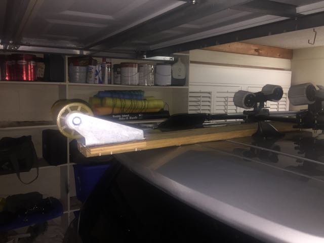

Here is the device I built, photos and video.
Sorry for lousy quality.
I can reshoot if anyone is interested:
https://youtu.be/bLjWbXEejqk
