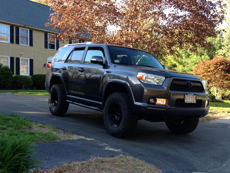

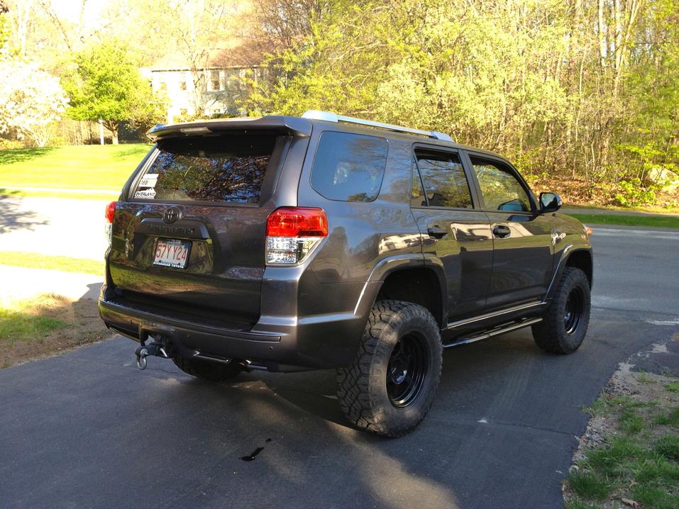

I did all of my chrome trim. Just need to do the roof rails. This is how it turned out.

Nice. Were the door handles a PITA?
Thanks. Kind of. At that point I didn't even mask off around them. Just sprayed thick enough to be able to pull the dip from around it off. I got into the back of the handles as much as I could but they're not fully coated in that area. You don't see it anyway. But for future reference, when you do mask off where you want to paint, make sure you leave about an inch between what you're spraying and the tape. This will make it much easier to peel off and shouldn't peel what you intended to spray. Any overspray can be easily wiped off with a microfiber towel.
