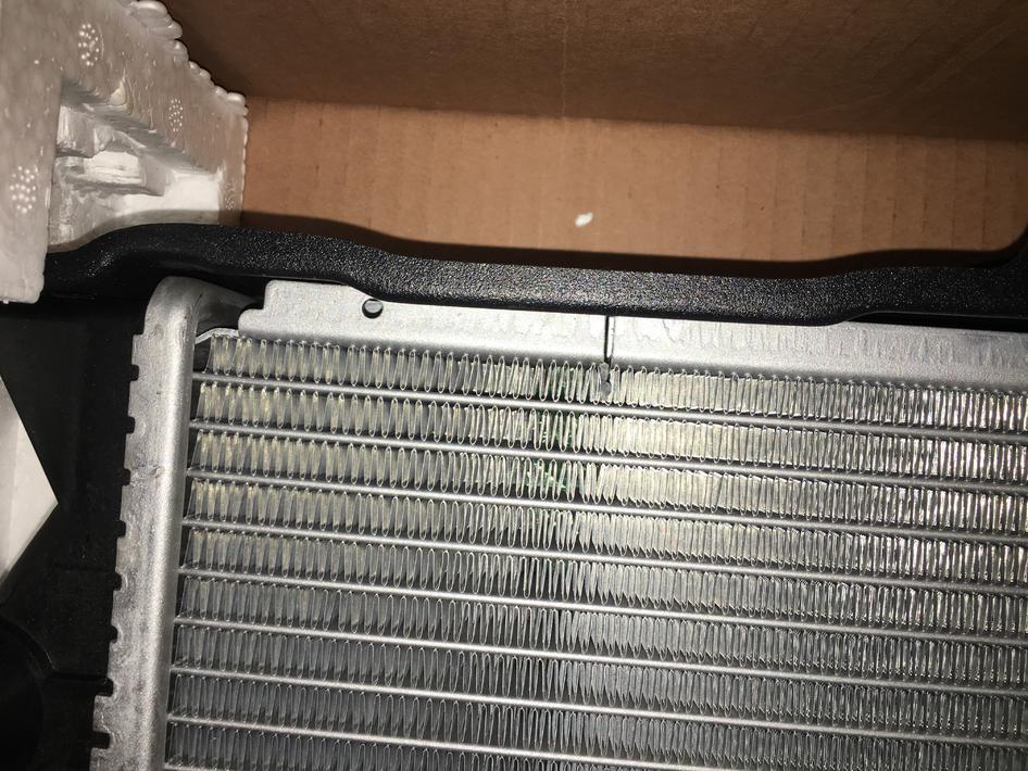

Got a radiator are these slits acceptable or is this something that needs to be returned.
I'm about 2 1/2 years late on this......The manufacturer says those slits are put in there to better allow for expansion/contraction of the radiator as it heats/cools. Right or wrong, that is what the manufacturer states.
