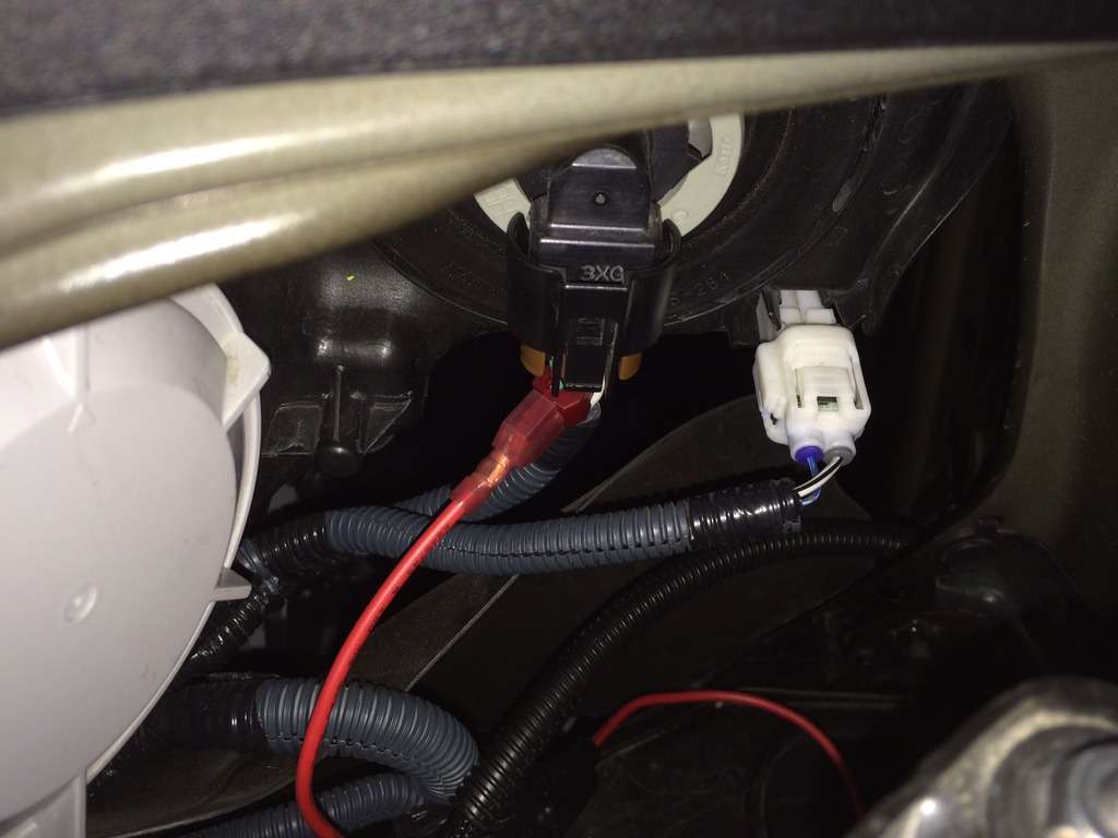

You can look at my link.
Switched and triggered so I can control if I want my LED Light Bar to come on when the High Beams come on. If you want it just on the switch, just send the trigger wire to 12V when the key is on....

Here is the photo.....
High beam wire

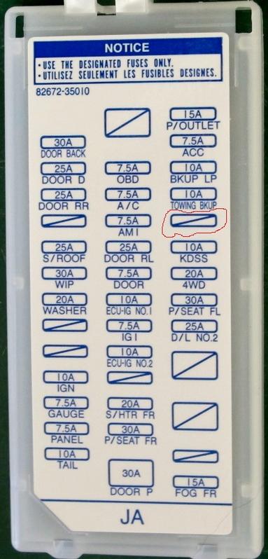

[MENTION=91899]Jhalko[/MENTION]. At this time, I simply want to tap into a switched circuit at the fuse box or unused under dash connector. This will allow me to turn my LEDs on any time I want.
Weather looks like crap today in the Denver metro area, so I believe I will see about installing my light bar today and take a look at the underdash fuse box for any unused switched circuits or connectors.
For the future, I am purchasing a 9005 extension harness (I believe this is the correct one) to connect the 12v trigger to the switch just in case I become tired of manually turning them on/off.
In looking at the underdash fuse box, there appears to be an unused switched circuit (tested via meter) just under the 10 amp "towing bkup" fuse (far right).
If so, I should be able to use that for my 12v input into the switch.

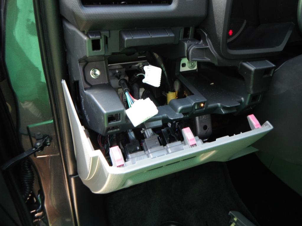

You guys are silly.
Put your hand in the hole surrounding the steering column (left side) and behind the top of that lower panel. Pull. Panel pops out far enough to get to everything. The panel above that literally pulls right off... No cut hands. Easy.:wow:
I will be removing the top panel to mount an sPod. Did you have to remove one before the other or did you see or notice if you could just remove the top without removing the bottom first? Thank you
