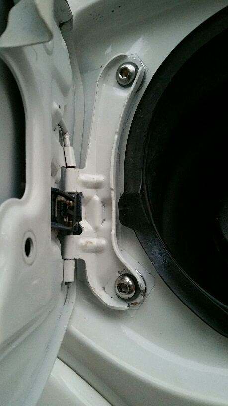

It was really easy. My paint was failing on the door and I just repainted it. I'm still waiting for the paint to fully cure.
1. Drill out the rivets. There is 2 and I used small but the a little larger.
Max 6mm equalivent
2. Pull rubber seal for gas cap towards center the inward towards vehicle.
3. I cleaned brushed and painted it

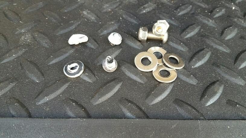

4. I replaced rivets with a 10mm head with m6 1.0 bolt and nut. Fit pretty snug This is what I had and you can use what ever you want. But I recomend stainless
5. Slide a nut behind and hand tighten.
6. Align gaps to body then torque it down.
7. Reinstall rubber boot
Sorry pic is wrong. The 2 gold looking bolt heads are what I replaced.
I replaced the rivets with the following stainless hardware; internal hex buttons (6mm), washers (fender) as spacers to bring the fuel door further away from the body, and nylok nuts.
The back of the hinge/area is accessible from where the jack is located.
Stick a couple pieces of duct tape on the back of the rivets, to keep the pieces from falling into the deep.
After drilling through, I grabbed the heads of the rivets with my needle nose vice grips and twisted them off.
The area underneath the hinge is only primed (not painted).
My local Ace Hardware had all the hardware in stock.
