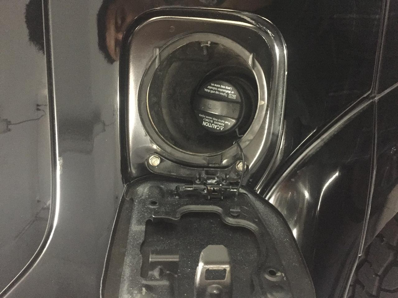

Got my first fill up the other day and had this same problem. Searched through all the threads with no answers. The door is riveted to the body so i have no idea if you can just put another one on. It's super annoying. I'm going to try and bend it tomorrow
It was really easy. My paint was failing on the door and I just repainted it. I'm still waiting for the paint to fully cure.
1. Drill out the rivets. There is 2 and I used small bit then went a little larger.
Max 6mm equalivent
2. Pull the metal ring out and push rubber seal towards center the inward towards vehicle.
3. I cleaned brushed and painted it
4. I replaced rivets with a 10mm head with m6 1.0 bolt and nut. Fit pretty snug This is what I had and you can use what ever you want. But I recomend stainless
5. Slide a nut behind and hand tighten.
6. Align gaps to body then torque it down.
7. Reinstall rubber boot
Sorry pic is wrong. The 2 gold looking bolt heads are what I replaced.

You can't reach it through there. Just push that rubber gasket back and you can reach around it. From there you can use a box wrench to tighten.
