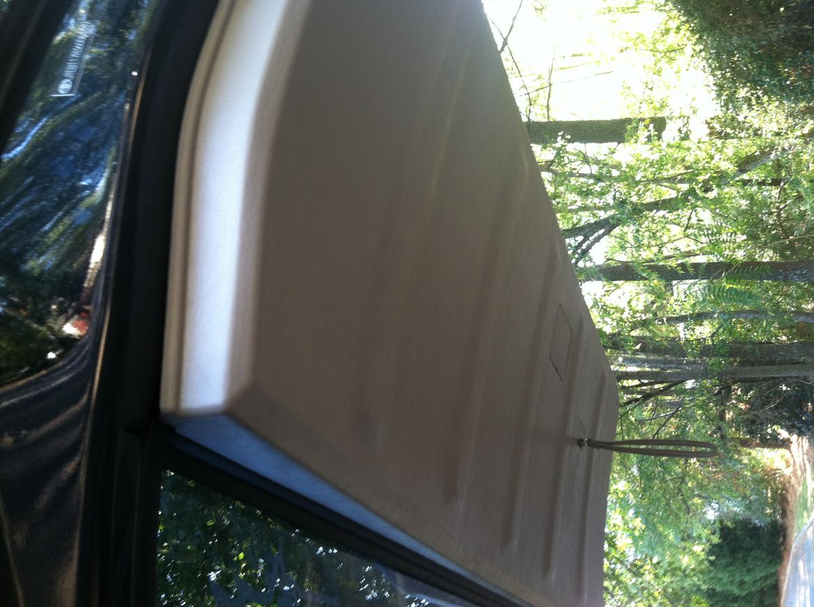

knightsfs4 New member Oct 22, 2011 #1 Found the source of my rattle from my subs, now I just gotta get in there and fix it. Here's what I need to get into. Does anyone have any pictures of how to take this thing off? Thanks Jack Attachments photo.jpg 134.2 KB · Views: 503
C CXS Senior Member Oct 22, 2011 #2 There 1 bolt holding the strap on that needs to be removed. Then grab the bottom of the vinyl and give it a good yank. That's all it takes!
martini New member Oct 22, 2011 #3 Here are the two guides I used: http://www.toyota-4runner.org/4th-gen-t4rs/67336-rear-liftgate-cover-removal.html How to: Replace Rear Hatch Opening Switch - Toyota 120 Platforms Forum
