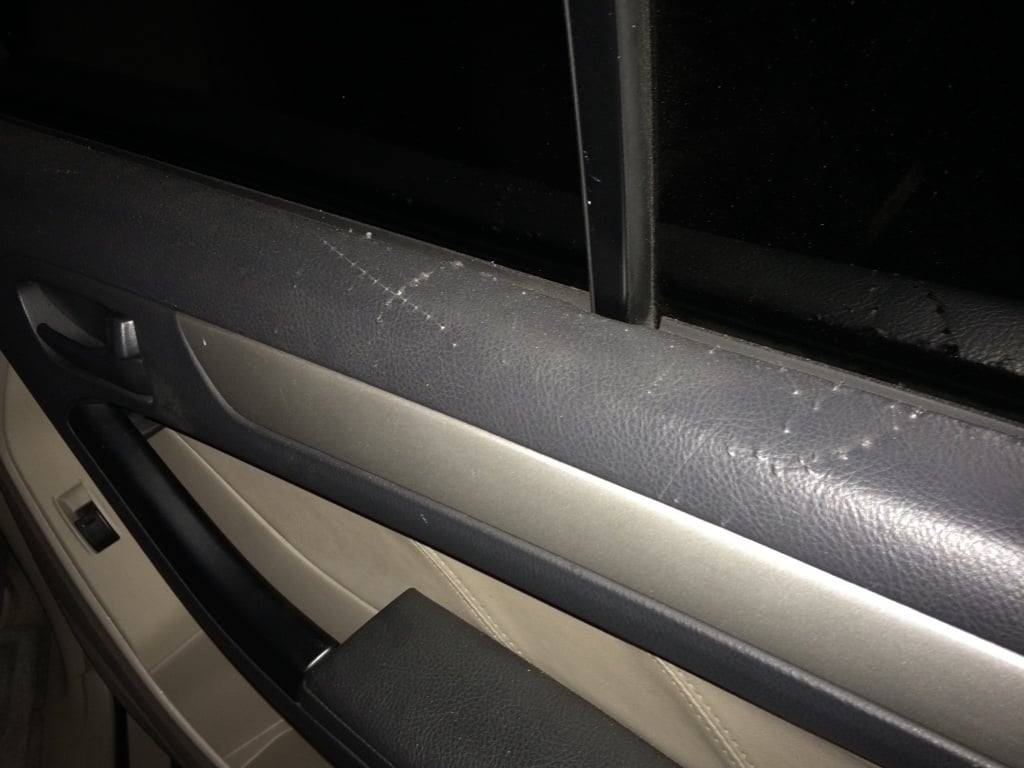

Totally agree, I wouldn't to the whole dash and all the trim, just the top portion on the doors (See picture) Whatever I did, I want it to look OEM quality when finished, not ricey
