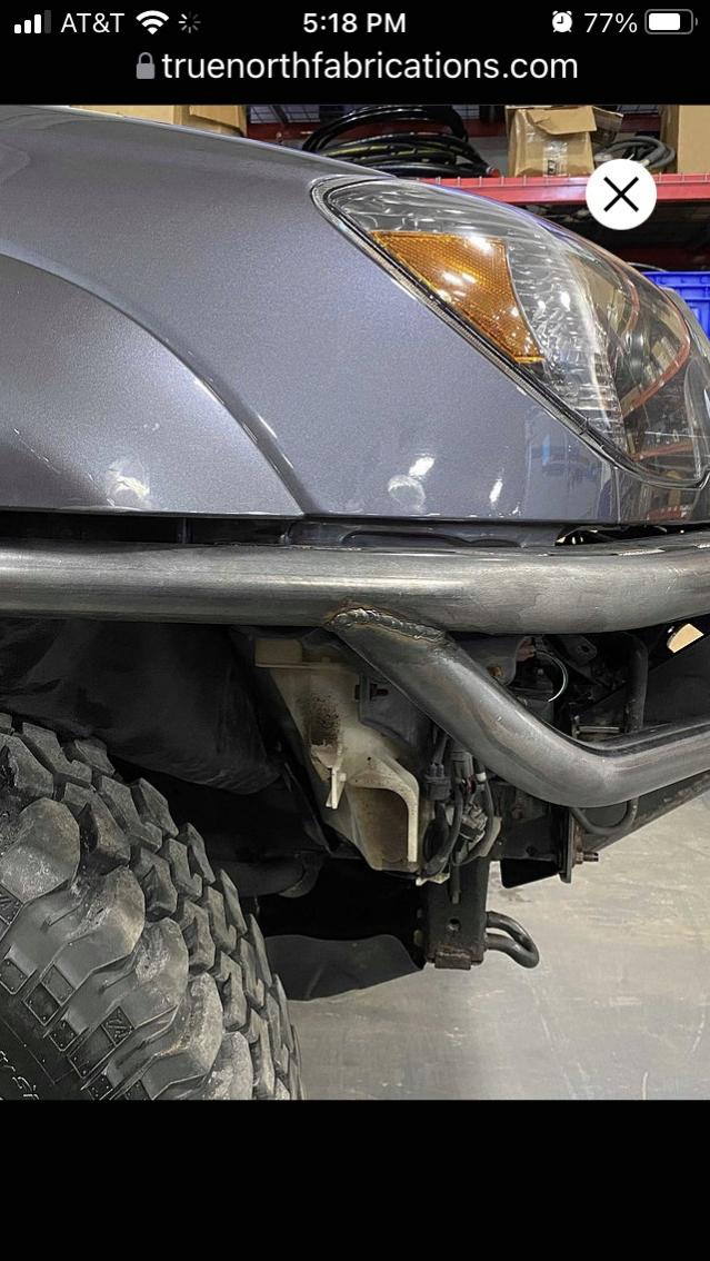

If the tank is busted it would be a great time to do the tank relocation mod. I did mine a year or two ago and prefer the new location. Also cleans up underneath forif you ever decide to get a steel front bumper. The factory tank will hang down and look awful when you install the steel bumper. The relocation tank is only about $20 on Amazon and relocates up into the engine bay.

Would you show a pic of your relocated tank, never seen one? Thx
This isn’t mine because I’m not at home and can’t take a picture right now but this is the same tank I used and it’s in the exact same location as mine. Silver rhino media is where I got the idea from.

Exactly. I’m getting my bumper ready to build in the next week or two and have my reservoir mocked up in the engine bay.
Photo off of the truenorthfabrications.com website.

Are you doing a custom bumper build? Or are you going with the true North Fab?
I bought the True North DIY kit during their Black Friday sale. I purchased it without the upper hoop and have a buddy that will bend one for me custom.

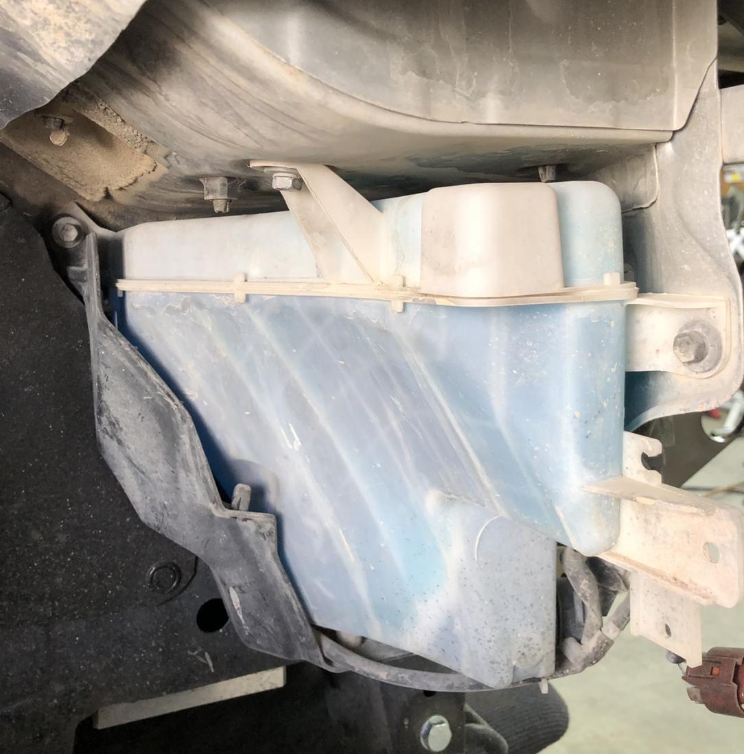

I pulled my fender liner out while getting ready to install my bumper and snapped this pic for you. Once the fender liner is pulled back there are three bolts to remove. Forward facing on the right. Vertical on the top and left side inward facing. The black shroud comes out with the lh bolt. Hope this clarifies any questions you have.
Thank you, that helps quite a bit. Much bigger of a tank than I though it'd be.
