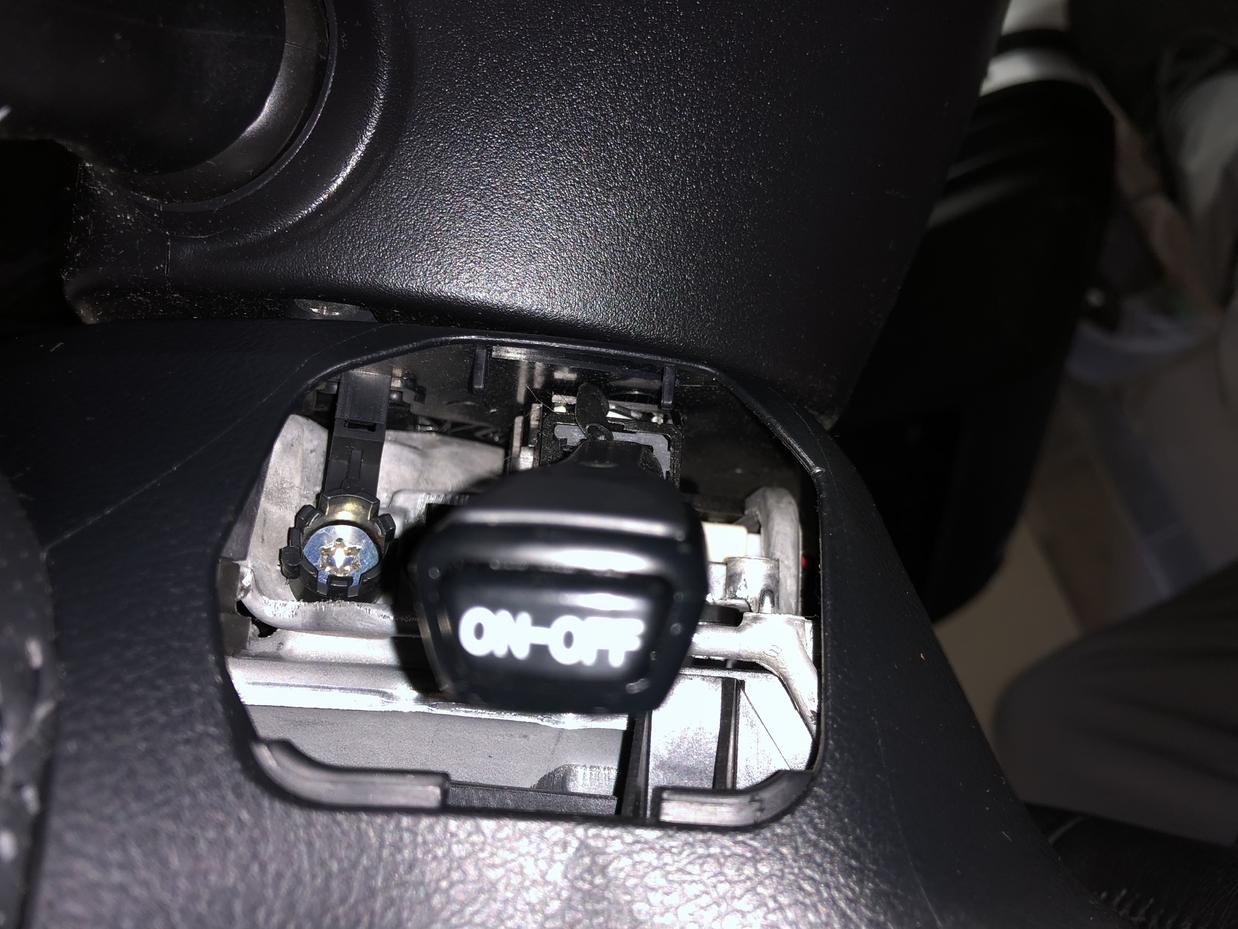

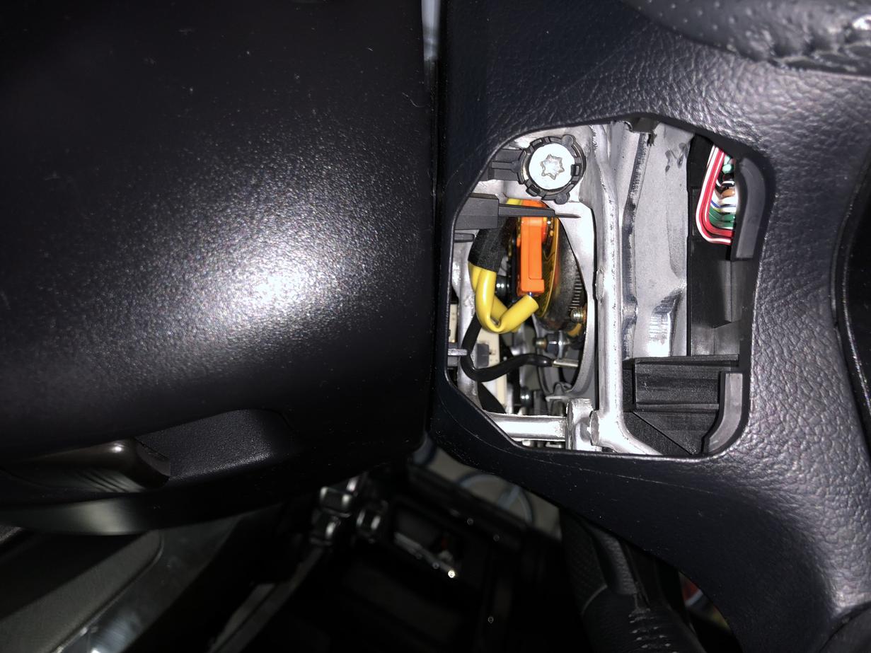

2. Remove the plastic covers found on the back of the steering wheel. Use something like a plastic tool, flat head or knife. They pop out fairly easy and expose the next step.
left side:
right side:
3. Using a Torx 30 (maybe 25, but pretty sure 30). Unscrew the bolts found (In the pics above) when you removed the plastic panel covers. They should break free pretty easy and don't worry about getting them all the way out, the steering wheel rear cover has a clip that keeps them in place.

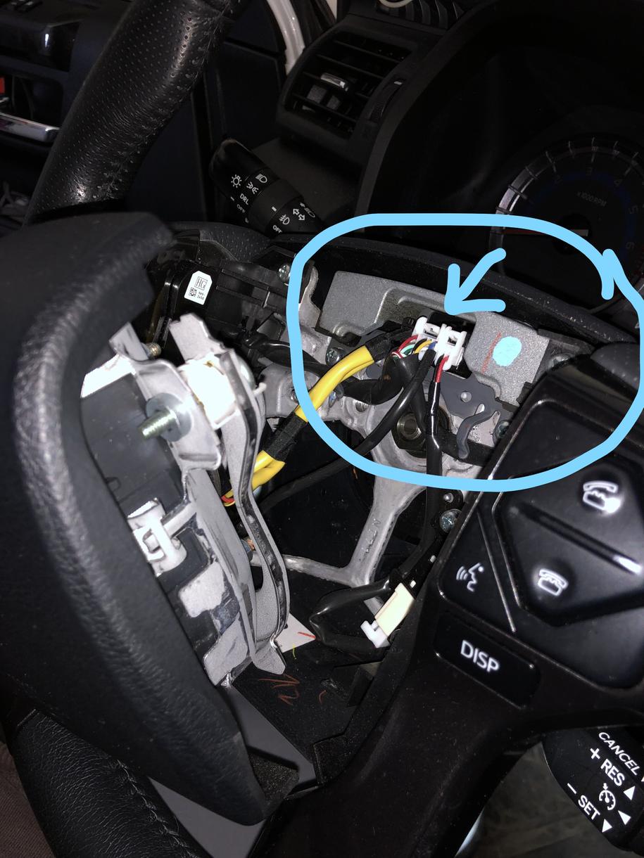

Remove white wire clips, FYI the airbag and controllers are all bound together.

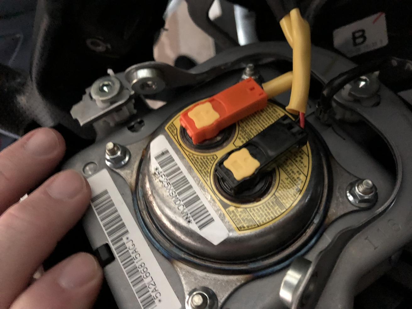

4. Removing the airbag. On the rear of the airbag, there are 2 yellow plastic clips that lock the connectors in place. You will need to use a knife, flat head or plastic removal to pop these up. then you will be able to remove them. If you need to remove the bag from the steering wheel, you will need to move the steering wheel controls also. This is done using a Philips screwdriver, or power tool...your choice.
Back of airbag:

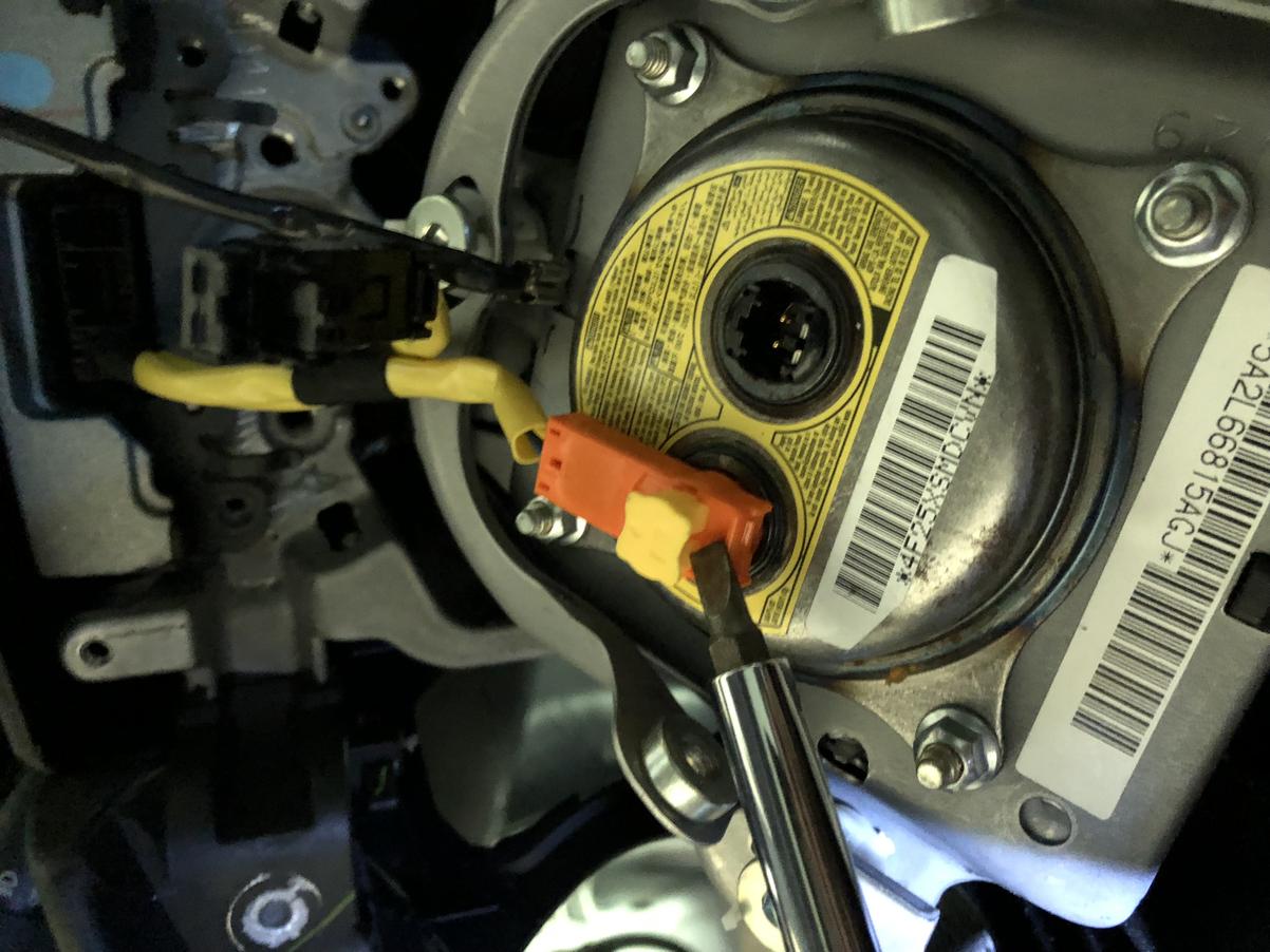

Once popped up, pull the yellow clip locks out:

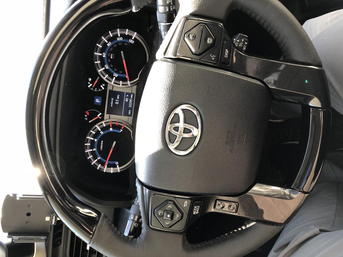

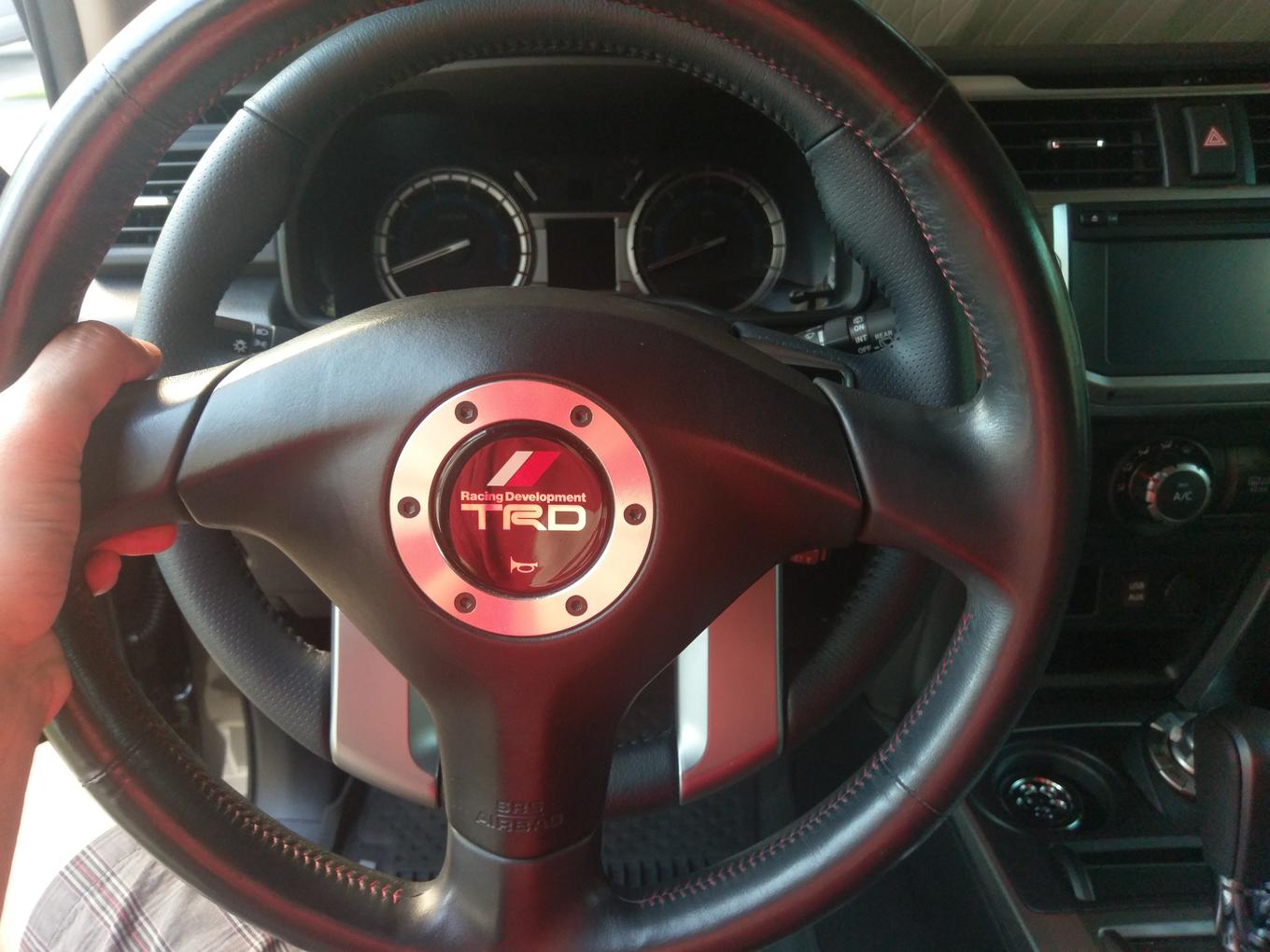

5. Now that everything is off, do your thing. Fix the controls, clean or in my case- do the wheel swap. No pics of this, but went to O'Reilly's and rented the steering wheel puller and done.
Finished product: (Don't know why the whole sideways thing has snuck back in m y life

Good write up. What did you swap your steering wheel with ? I did this swap a while ago for shits since I have it sitting around from my old truck. It could work, but the 4Runner clock spring would need to be modified. Not willing to do it right now, but it looks cool
the last pic is the swapped. A member here posted an ebay 20% coupon, so I pulled the trigger on a gloss black/leather wheel. The leather on my '16 is beat already, so I swapped for 1/2 wood 1/2 leather. I hope it holds up better than the OEM because the OEM is pretty bad.
