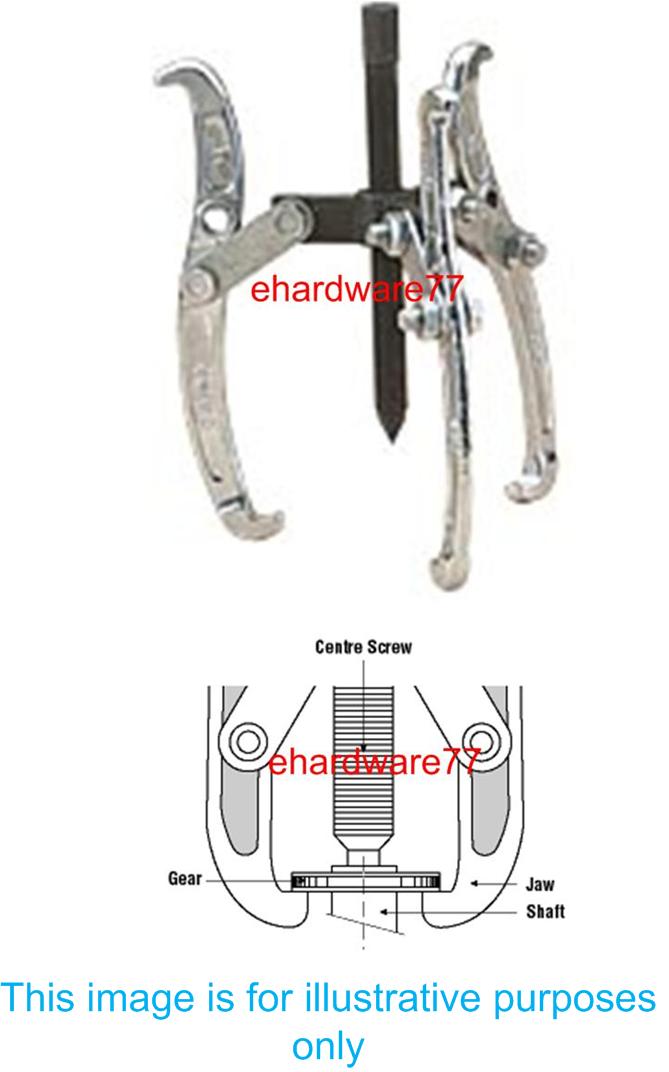

with a three jaw bearing puller, and put the bolt on the bearing puller on the threaded axel shaft, but be easy with it and then you can loosen the bolts the rest of the way
Looks like this, ,, i really wish i had my camera with me at work to show you

I'll have to try again. I was trying that but it is pulling the steering knuckle/bearing and hub off the axle.
