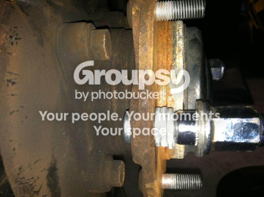

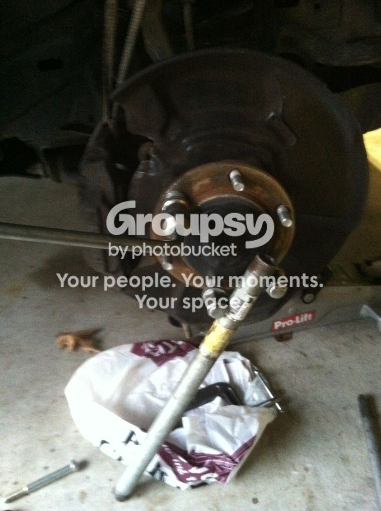

Recently broke a wheel stud on the front right tire of my 2005 and wanted to share some pics and notes to get this done quickly. I picked up a wheel stud from advanced autoparts for 1.99 plus tax.
Firstly, you deff have to remove the caliper and rotor. Without the correct tools this could easily be the hardest part of the job. Specially if this is the first time you are removing your caliper and rotor or it has been thousands of miles since you last took it apart those suckers will be seared on there.
The two caliper bolts are a pain to remove as they are torqued to death. If you dont have air tools, a steel pipe to increase your leverage will be your best friend. Jack the car high enough so you can work under the wheel to properly fit the socket wrench inserted into a steel pipe.
If you release the bracket that guides the break line to the caliper.
You can get away with not removing the break line and moving the caliper out of the way. You just need some strong rope or nylon string to suspend the caliper out of the way. See the pic below.
When you are done removing the caliper. Hammer out the rotor and put it to a side. Hammer out the broken stud and it should fall right out.
Find some washers that fit around the new stud and make sure they are laying flush against the metal. See pic. Tighten a lug nut on the new stud until you see the new stud press in.
To keep the axle from turning while you are trying to tighten the lug nut on the new wheel stud see the last pic. You will see I used the steel pipe to keep the axle from spinning. I put on two lug nuts and braced the pipe against the ground so it wouldnt turn.
