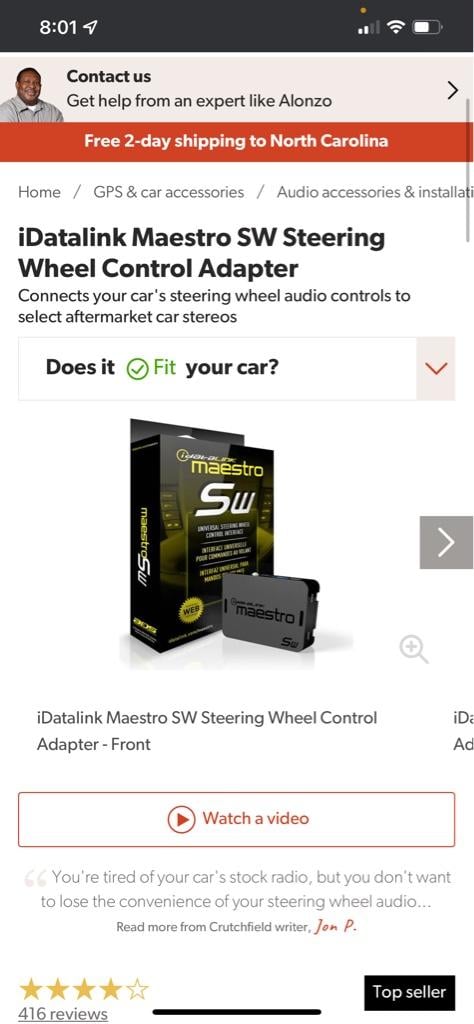

I just upgraded my head unit and needed to keep my steering wheel controls. I went with Maestro since its so flexible and I had so many issues with Metra.
Works great and i can add so many other features to Maestro. Had to get another harness for the rear amp. Such a pain.

Do you have the JBL system?
I got the Crux harness but I can't get it to work.

I didn't have the JBL system and my issue was with the hidden rear amp that needed to bypassed with a special wiring harness.
The Crux harness is not working with the steering wheel controls. Get the Maestro, a few different versions but they are the best.

Thanks Ripper, I will try it.
