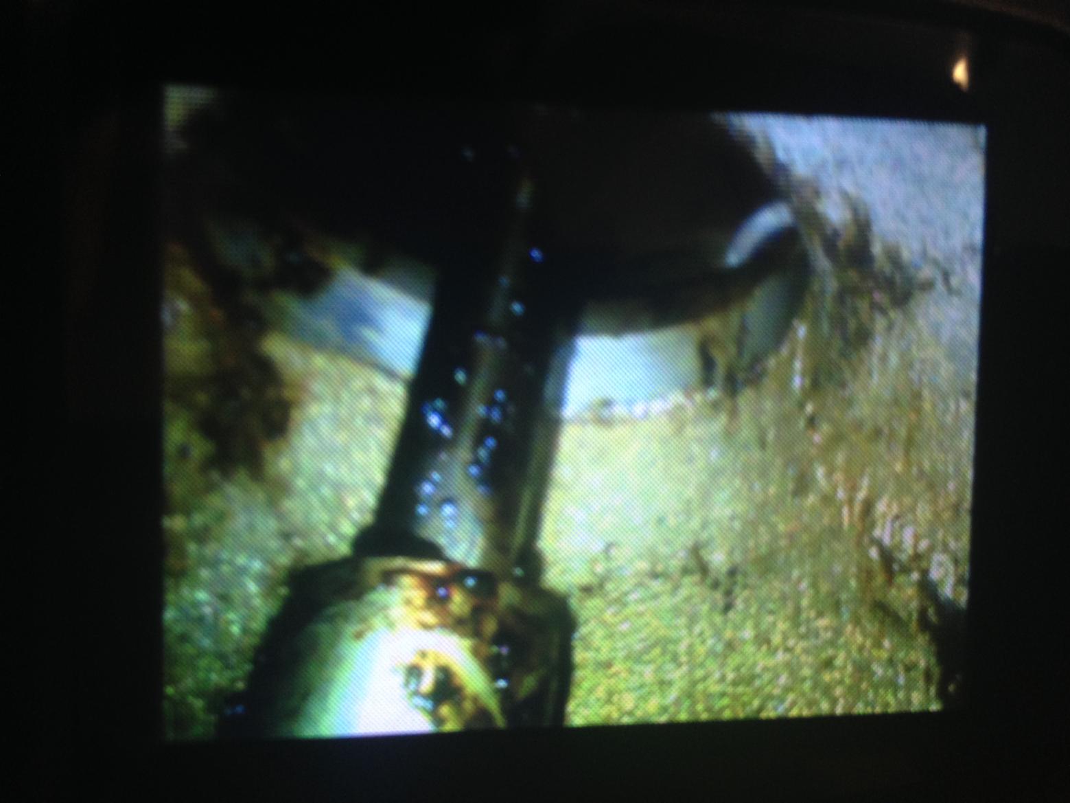

Here is a picture I took on the borescope, image is upside down, washer is on the right side. The valve looks to be open 1/4-1/2", not enough to get anything inbetween and still pull the washer back up.

That looks like it is sitting on the backside of the valve still.

I did finally get it out. I had to pull the intake manifold, use the inspection camera, and use a piece of safety wire fashioned into a hook. It was like a doctor performing surgery, nerve-racking!
