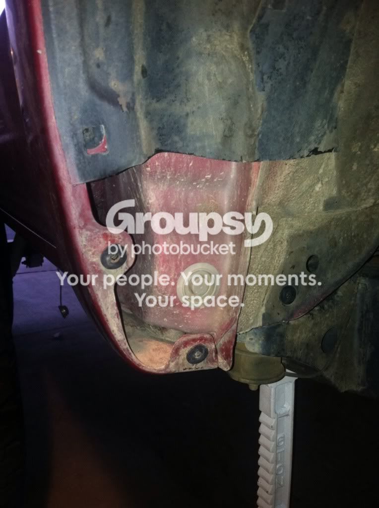

Here is what i did. I basically just did what brian2sun did except I have a 2 inch body so i had to trim a little less.
I removed the coilover and jacked it up to full bump and trimmed and pounded until it was clear from lock to lock.
here are a few pictures of what i did
Before (only trimmed the fender liner so far)

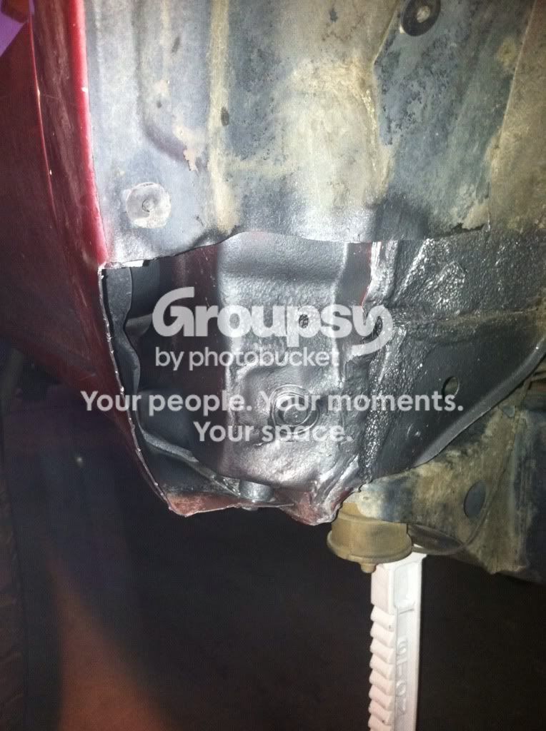

trimmed and pounded.

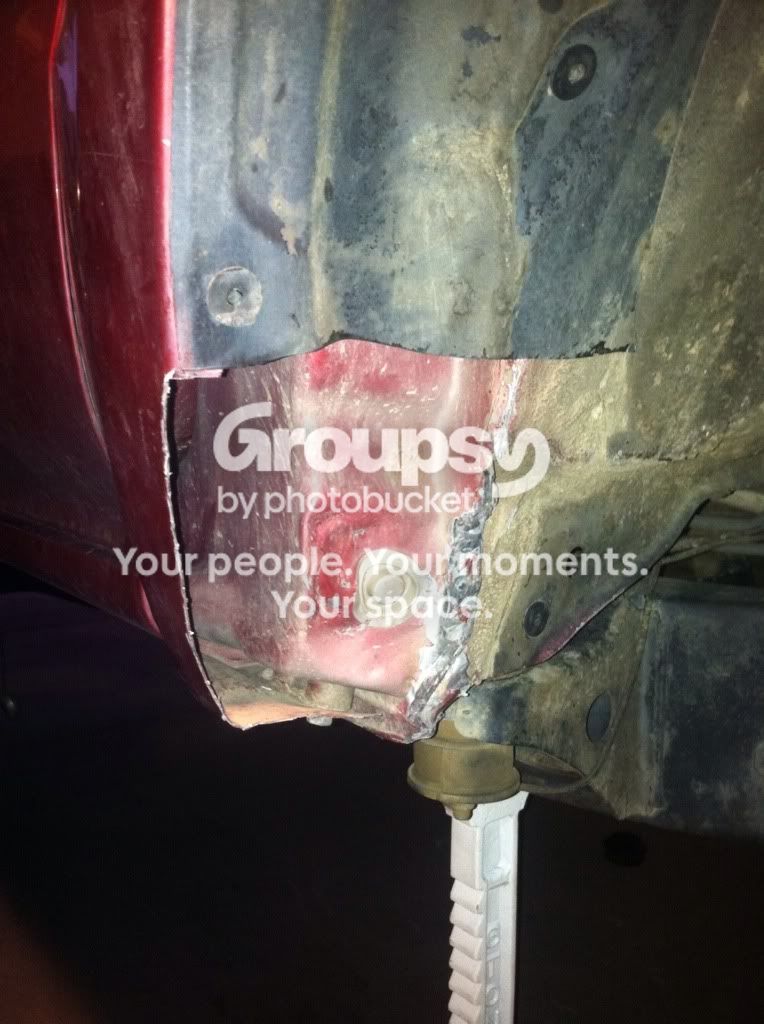

Painted and finished
6d7f61fa.jpg~original
Thats all i needed to do for 35's with a 2 inch body lift and full bump.
