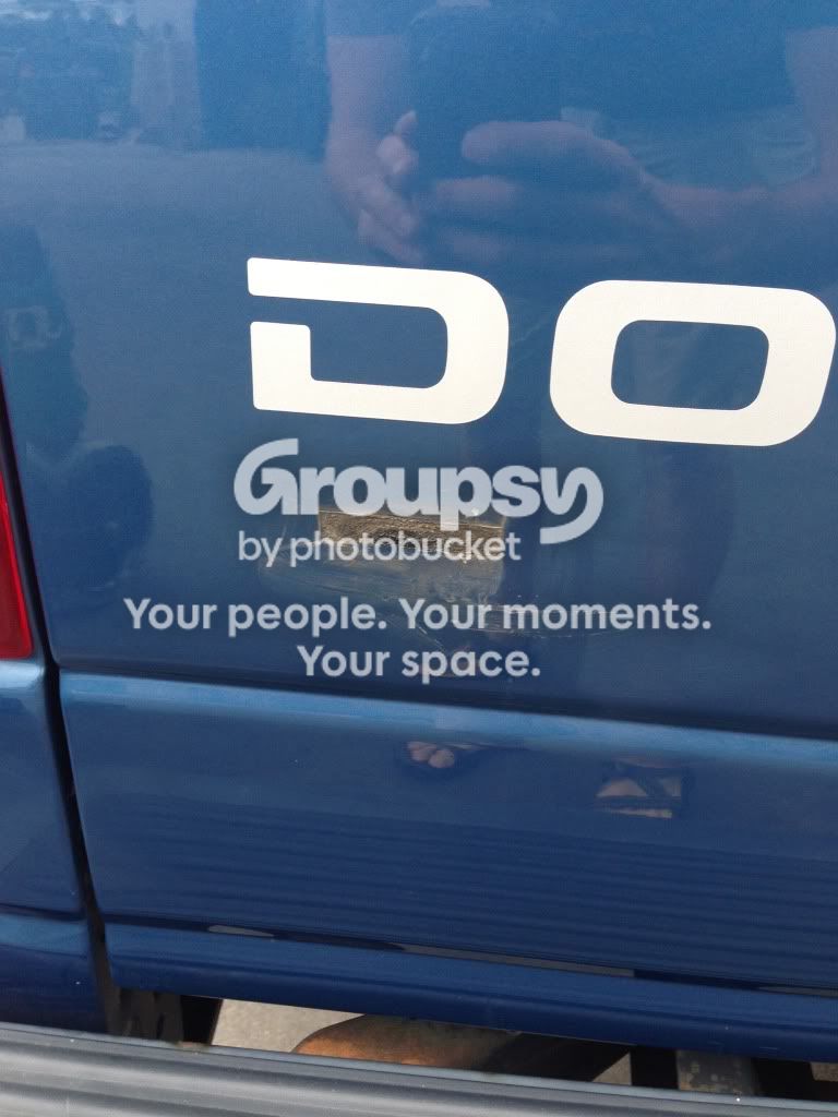

How to safely remove adhesive from dealer decal?
We took my wife's 2003 Dodge Dakota in for a wash/wax/detail, and in the process, the dealers emblem came off the back of the truck. What's left is the adhesive.
null_zps74c91cc1.jpg~original
Any idea how we can remove this without damaging the paint?
Thanks in advance!
-Joel
You can also use peanut butter - the oil will break up adhesive and it will wipe right off. Just let it soak for a while first.
Disposable straight razor?
Not on paint. Plastic razor and a liquid lube or a 3m stripe off wheel. I just ordered one from ebay. I'll post results after I get it and use it. Check videos on youtube, pretty impressive results with it.
