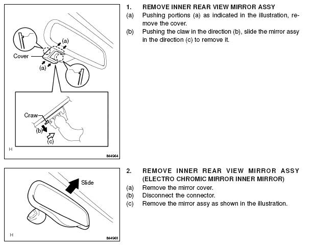

Assuming you have the standard mirror, there is a cover to take off. Under it is a claw at the bottom. Push the claw away from the windshield and lift up on the mirror. It should slide up.
The new mirror should use the same mounting.
Maybe this will help:
John:
diagram was perfect.
either i am getting old and weak or they are putting these things on better than when i was younger.
i needed a vise grips to get the plastic cover off.......
then, after playing with a screwdriver, i used my finger to move the claw (or tab) to unlock the mirror and then it slid off easily.
