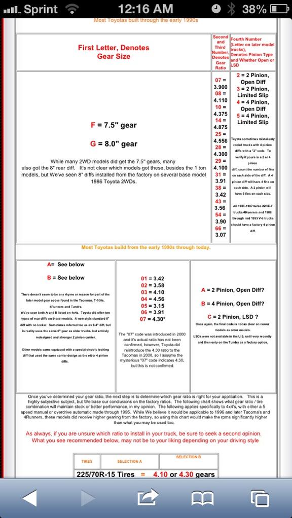

Look for the G144 code on the door jam. This denotes the 4:88 gear option. I got mine out of a '93.

Link with some info on Toyota Diffs:
Erik's Toyota Differential info
I would definitely check the ratio before paying for any Junkyard/used thirds before I paid for them.
These trucks are getting old enough and pass through so many hands that depending on the VIN code or a seller's word that things may have been changed from stock
