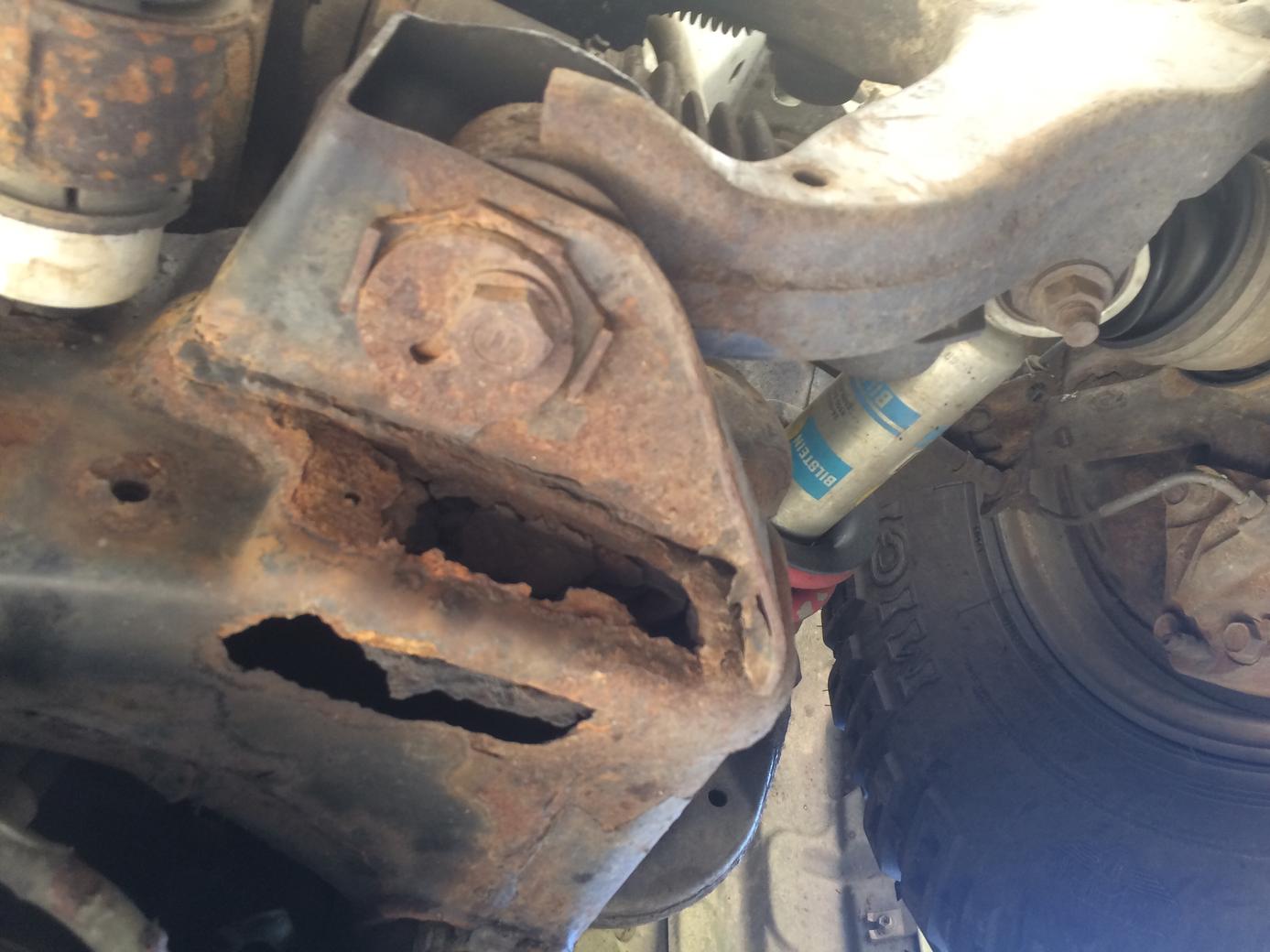

How would I repair this frame?
yotamaine
I'd really appreciate anyone chiming in on this is hate to junk this, is it repairable?

You need to find someone who can fabricate and weld to patch that. Looks relatively easy for an experienced welder I'm sure.
Yes, very repairable. Start searching for a good local mechanic. I have never seen a frame rust out in that area though. Definitely spend some time poking around the rest of the frame. The typically worst areas are the inside of the frame rails on either side of the rear lower control arm mounts.
Thank you guys I appreciate the info, maybe not for everyone, but that's exactly what I needed to hear, I've inspected the frame taking a small hammer to it so I could see if there was any where's else that was that weak, only spot I could find that was even close to this bad was the passenger lower control arm mount as nh said but that is just a hole probably the size of a dime which is also gonna get repaired Asap. In terms of strength will it hold up well being repaired? I know there are plenty of things to take into consideration but let's say it's was done well.

I'm going to be the first to say that is NOT just a patch job. That is a structural portion of the frame. You better be damn sure you get everything out of there. I would not want to be driving on that with just a patch job. I have rust on mine, and have even done some frame repair. If I were going to do that I'd remove everything, cut off the LCA mounts, remove the frame, weld in new frame, and weld on new parts.
Looks like the maine winters finally got you. I just had the inside frame rail at the rear lower control arm done on mine. Easily repaired by an experienced welder.
Thats sounds like the best route when I call around tomorrow I'll mention that to see what some welding shops around here think wish me luck

Which ever way you do decide to go...either a patch job or complete replacement...once you have it repaired you need to take some time and love on your 4Runner. You need to put some quality time on preventive maintenance or you're going to lose the rust war!! Get under your rig and sand off all that rust. Once you sanded it down...paint it with some POR or other type of rust inhibitor. It sucks...I know!! Been there...done that!! But you have to do it. Unless you have more money than time...then I guess you could pay someone?? I just took about an hour or so each weekend and broke it down into sections. Sanded down an area and then painted it with POR15. Before I knew it...I was done. Now, in the fall, I'll take a day and check the undercarriage. Places that have been hit with rocks or whatever...I'll clean it up and re-paint it. Doesn't take long at all now.
Hey, one more tip...don't forget our frames are hollow...with numerous holes. Make sure you spray your paint/coating inside the frame also. Otherwise you'll just rust from the inside out.
