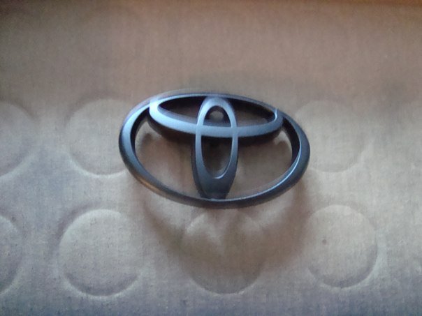

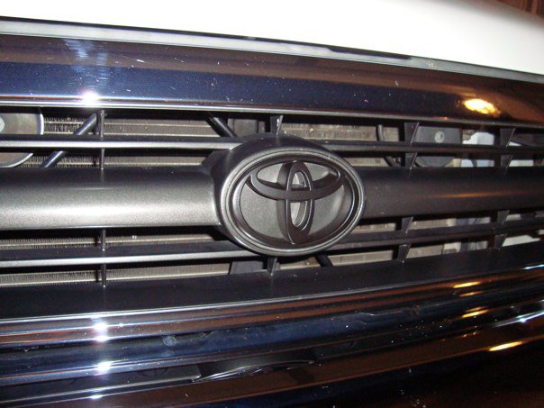

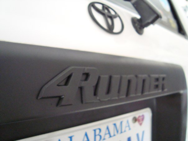

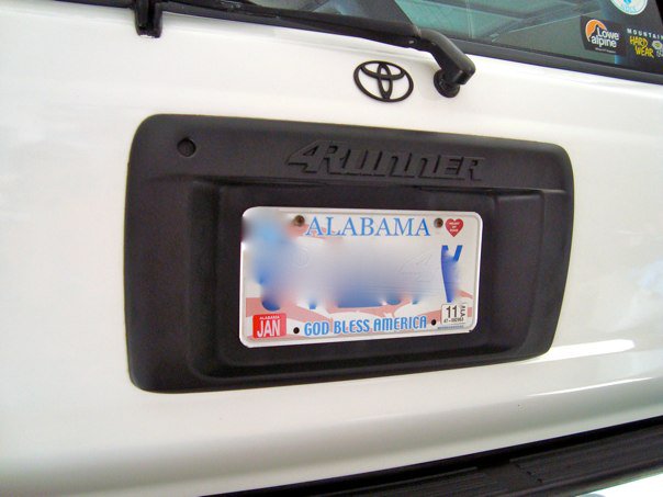

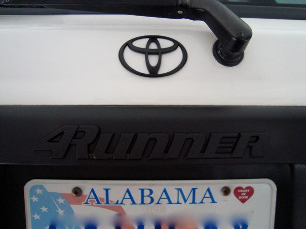

Here are some pictures of the finished product. 3 coats, one every 30 minutes, probably could have done 4-5. But still looks fantastic, let me know what you think. I picked this idea up from a buddy of mine with a GTI. Hope this helps!
Front emblem:
Back: I Plasti dipped the whole center, i thought the black on black looked awesome and a black emblem would look funny against gray..

Yeah it seems to hold up really well. Just put enough coats. One thing to be careful is, you cant just tape off things with Plasti Dip like paint. Like when i did my back center pannel, i would tape it off, then when i was done with every coat, i would take the tape off while it was still wet. Because otherwise if you wait and take the tape off, it will have dried into that rubber substance and will be connected to your work and want to take it off also. Test it on a few things if you want. But thats about it. I painted my other emblems off of my truck and it works great.
Glad you mentioned that...makes sense and I wwould have done that exact thing...haha.
Did you take the license plate holder completely off when you painted it? How does that come off?

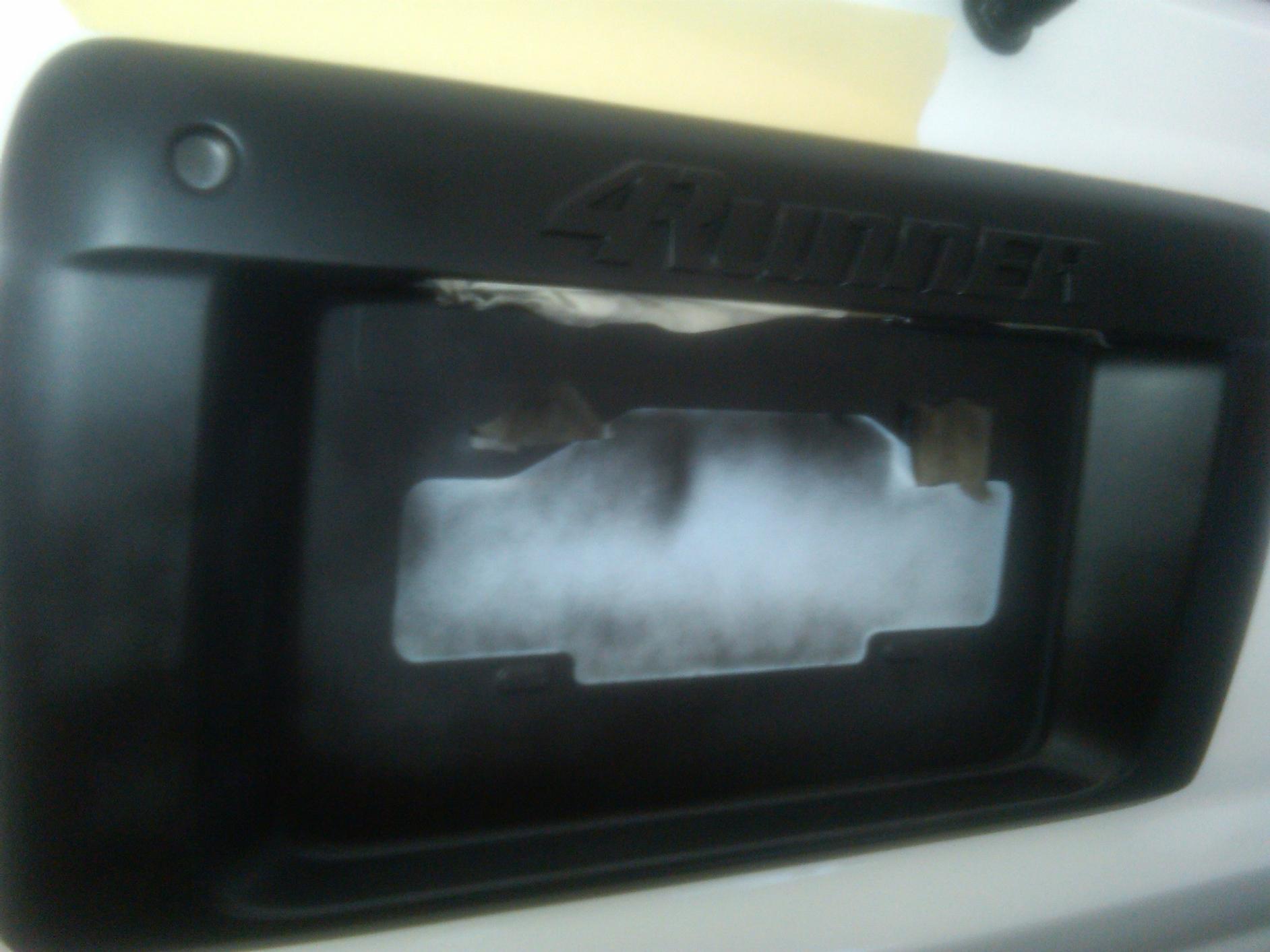

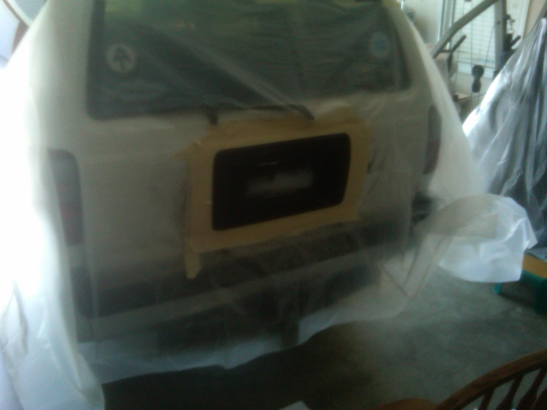

The plate holder was the one thing I did not remove, seemed like a lot of work so I did method of taping it like I mentioned. All I did was removed my license plate and covered the handle and lights.
This was the way I did it, proved to be pretty easy.
Sorry about the size of the pictures....phone pics
