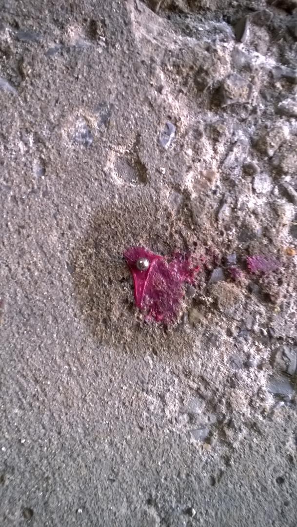

So I'm not sure if this is just freak coincidence or what... But I found what is pictured below this morning. Lol just a bb that managed to find it's way into some excess grease that I missed wiping off when I missed the zerk fitting? Or is this a ball bearing of some sort?? It was covered in grease when I found it, but staged this for reference lol. I haven't noticed any strange vibrations or anything... This was found directly below the ujoint in the rear, but those bearings look different within right?
