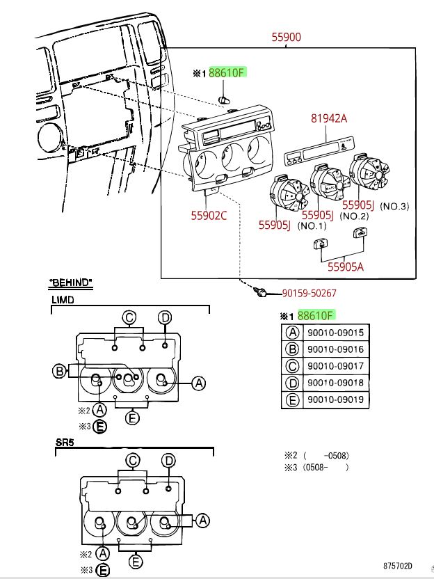

Does someone have the part number for the fan control backlight? I ordered 90010-01084. But that is not the correct number I guess as the part I need is green and these are red and smaller
Should be 90010-09015, or if you have dual-zone it's 2x 90010-09016
