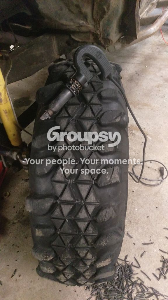

Did a little re grove on the front tires.
IMAG0686_zpsoulvrrns.jpg~original
I have a wider square blade for a different pattern on order for the rears.
Used a 1/2 blade for the rears with a simpler pattern, just to open the lugs up and take down the wear bars to help with tire flexibility
IMAG0708_zpscsk1ogaj.jpg~original
How much rubber comes out with this blade.
IMAG0707_zpsqzwjydyv.jpg~original
After a year do you feel your hot knife work did help or non noticable?
Sent from my XT1635-01 using Tapatalk
Definitely. Hook up much better in the snow, and seem to flex better around rocks. I have since opened up the fronts to 1/2 also. I want to go back and do some siping but am afraid the lugs will chunk off... my fronts are pretty dry rotted (their old)
