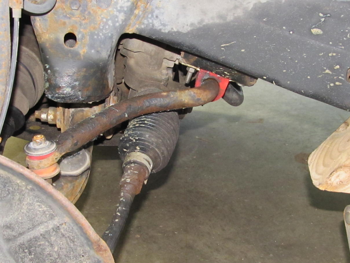

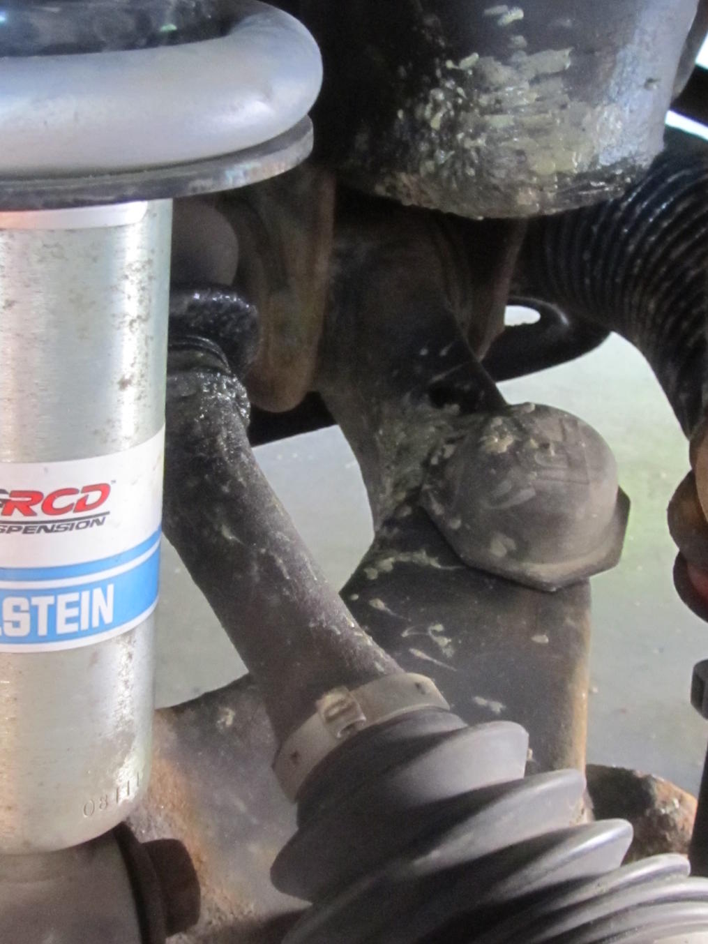

Put Tundra brakes on this evening and noticed the CV boots have had a jolly time spraying grease on everything behind them. I installed a 3" lift about 8 weeks ago. Was wondering if by installing the lift, changing the angle, then installing the diff drop could cause leakage in the boot seal or if there's a larger problem? Runner has 123k on it and I have all service records, never saw any CV boot or axle service. Passenger side had only a little leakage. Thanks for any help or advice -

Hmm, easier to change cvs? Maybe easier to do, but replacing the boots will be easier on the wallet. You can buy a reboot kit from toyota or go the upgrade route and buy some "longer" travel cv boots as i did. And there are no seals or anything causing that leak. Just simply a torn boot from the sudden angle change.

That's kinda what I figured. Just wanted to know if I should just go ahead and do the axles instead of just the boots since they are the originals.

Nope, no wheelin' yet, just street driving

Reboot, the toyota axles are generally better than any auto store parts.
I do happen to do alot of offroading in general, but my runner is my daily driver so it does see alot of street driving. But keep in mind that even in 2wd the cv axles still rotate. So even with street driving it wears the boots down. Ive seen some people use porsche boots that work, some use oem, but those will just wear down overtime. I personally used long travel inner cv boots by offroad solutions.

I vote you just reboot the Toyota CVs. As was already mentioned they are generally considered superior to non-Toyota.

Thanks for the advice -gonna re-boot inners and outers. Double and triple checked LBJ's and rad and both still in good condition. I do have a B &M 70268 in the truck waiting to be installed -
