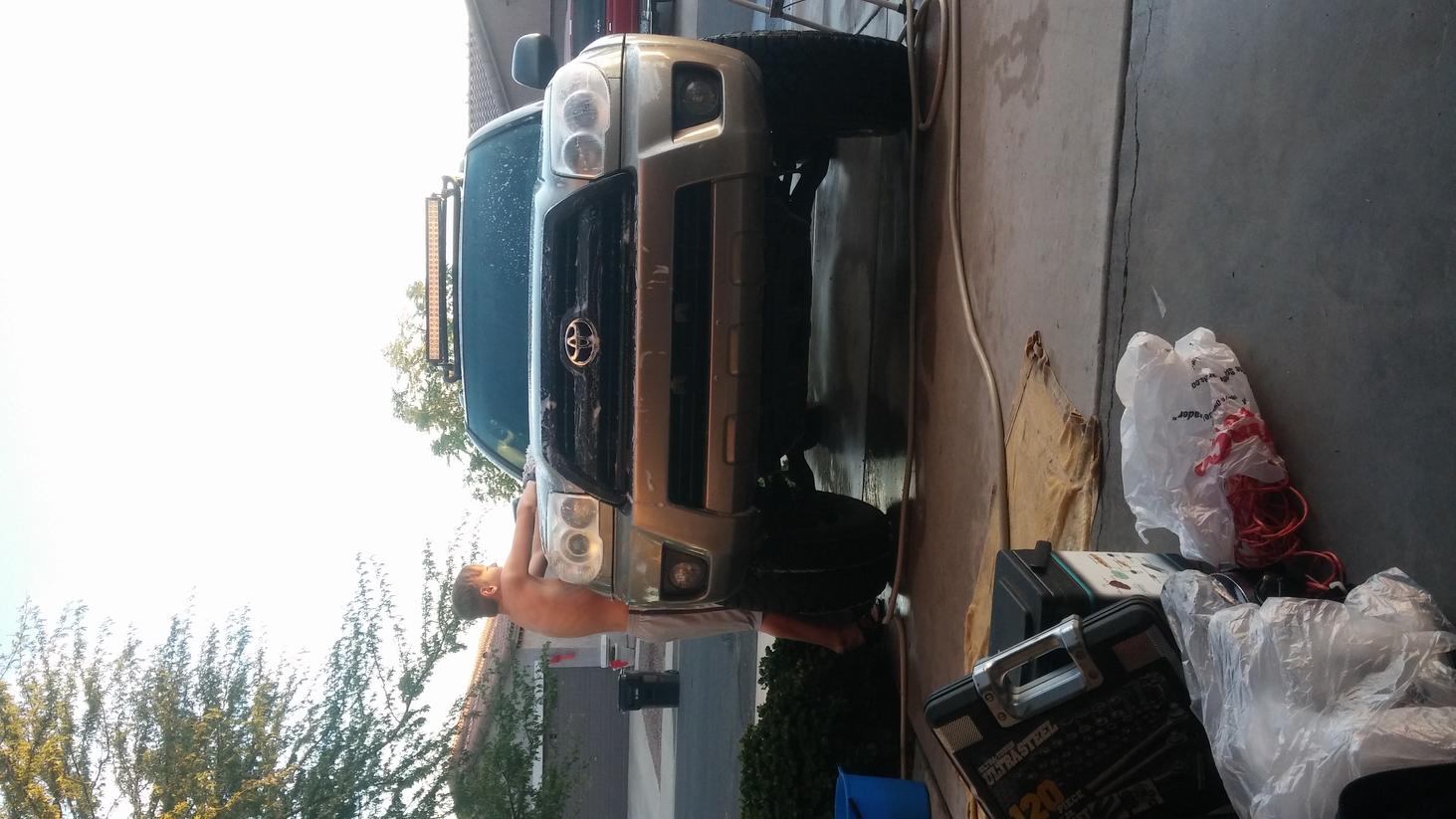

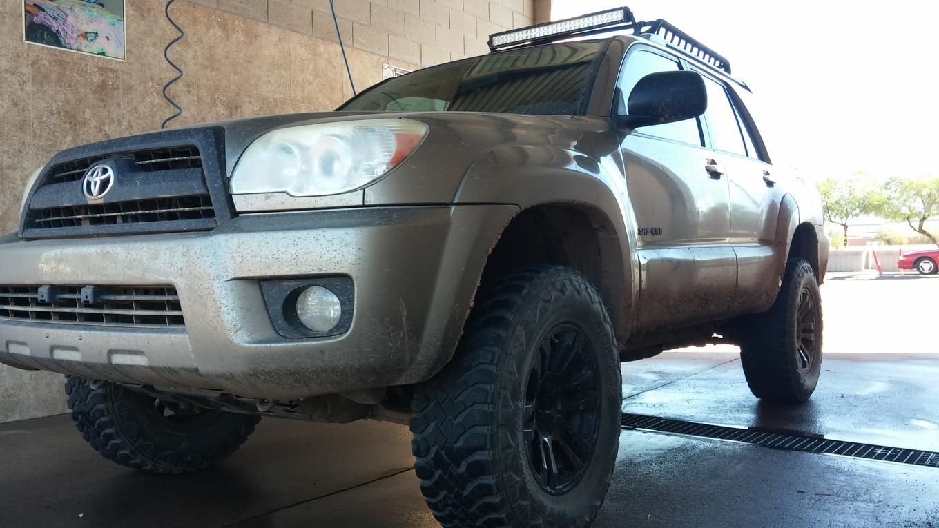

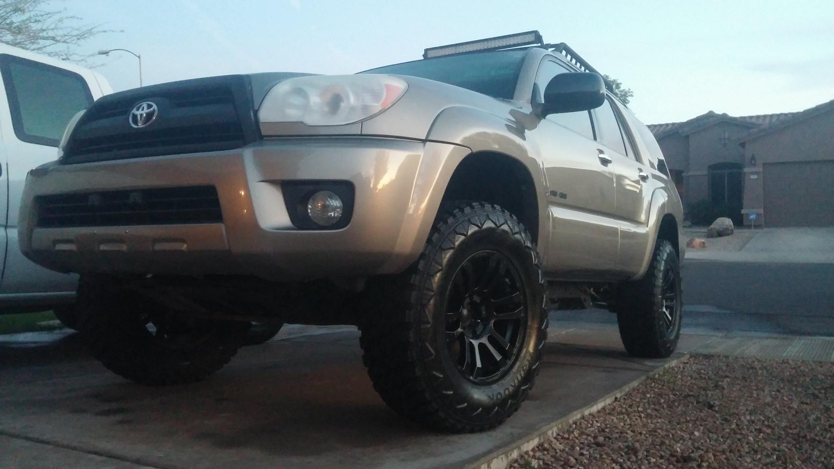

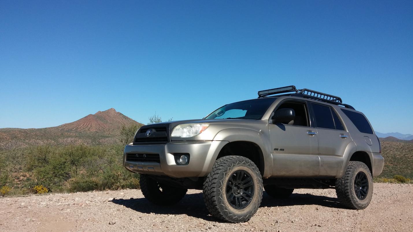

I researched before i bought my wheels to try to get the perfect stance, and i like them, but i want a wider now aggressive stance. Now my only option is wheel spacers.
Are there any cons to having wheel spacers, or to me having a wider stance. I just feel like it will give it a tougher more aggressive off road look.
What you guys think?
Pros/cons on road/off-road?

By the looks of it you'll be fine with 1.25 or 1.5.

In all honesty it does look good as is. The larger radius you swing the outside edge of the wheel through the more rubbing issues you'll have at full lock too.

The wheels you have probably give you 1.25" per side over the stock rims. It looks pretty good to me!
