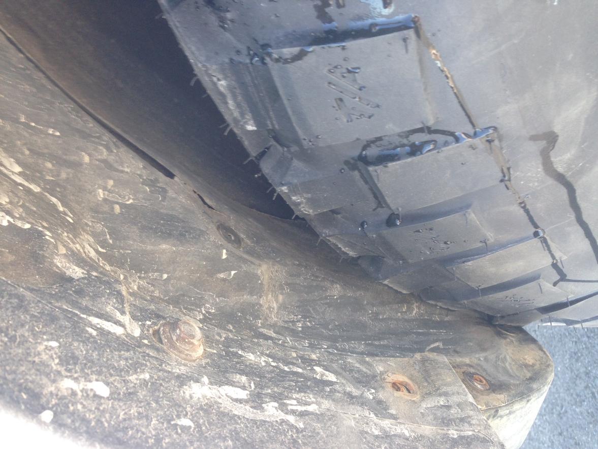

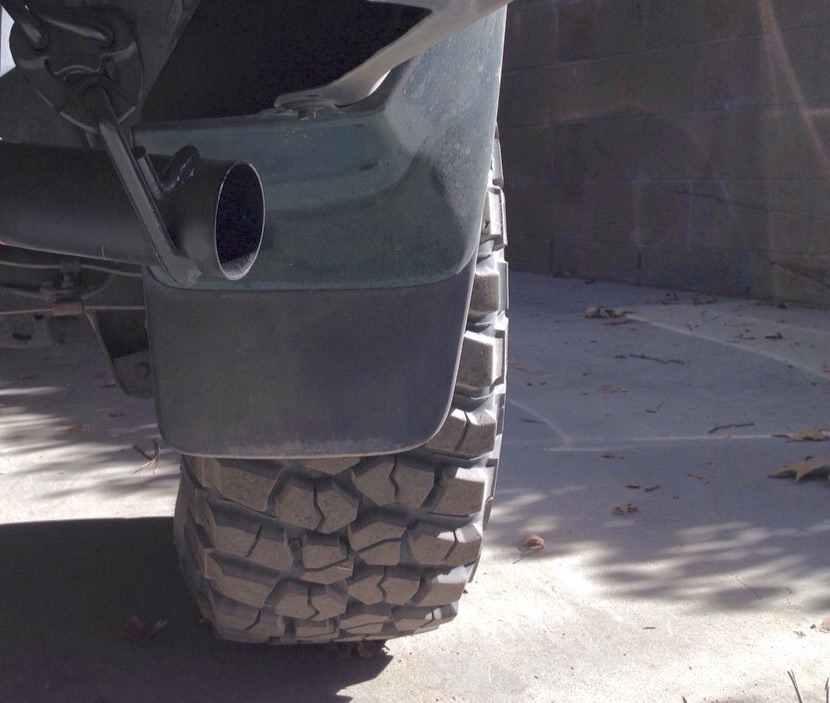

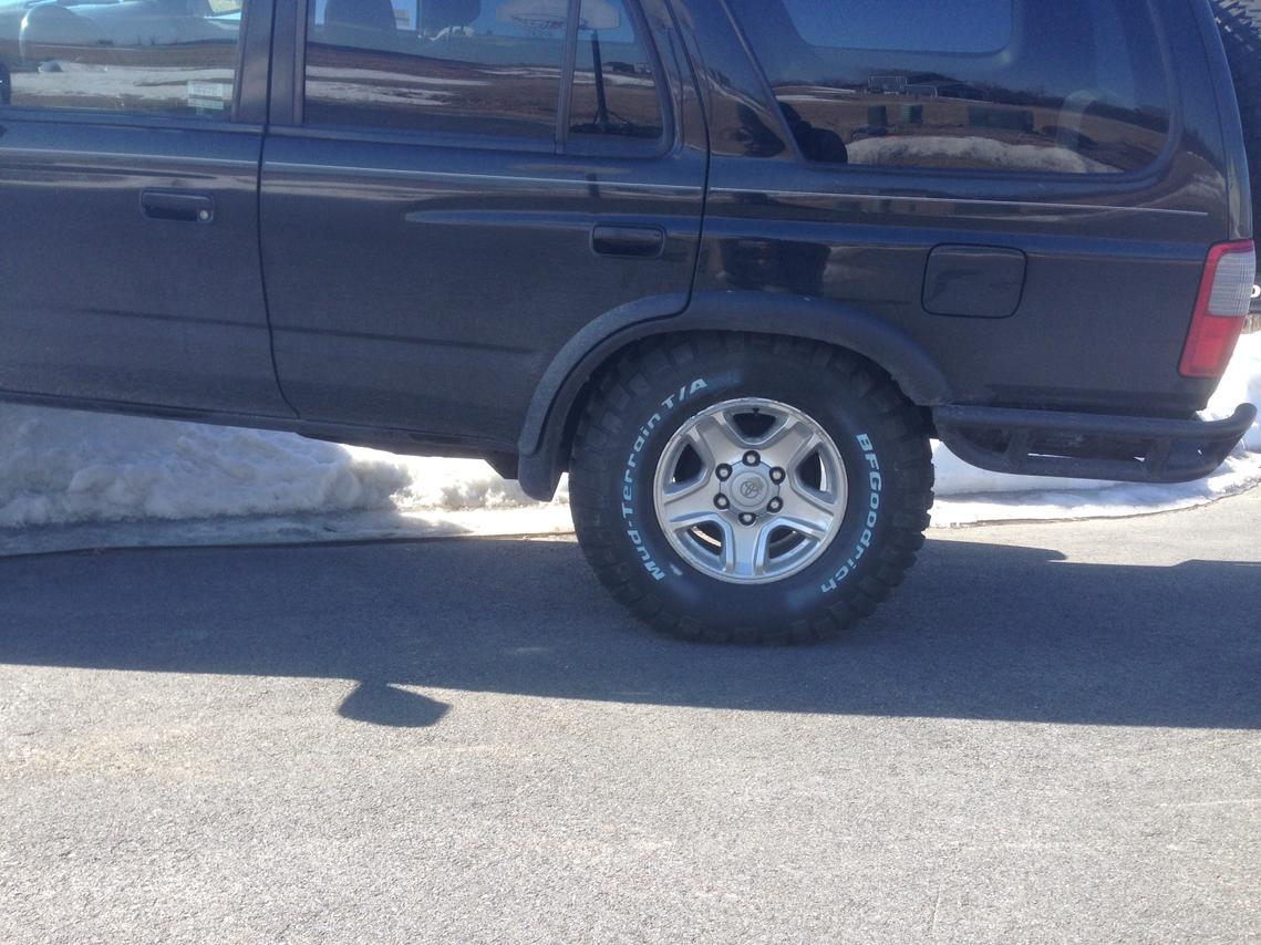

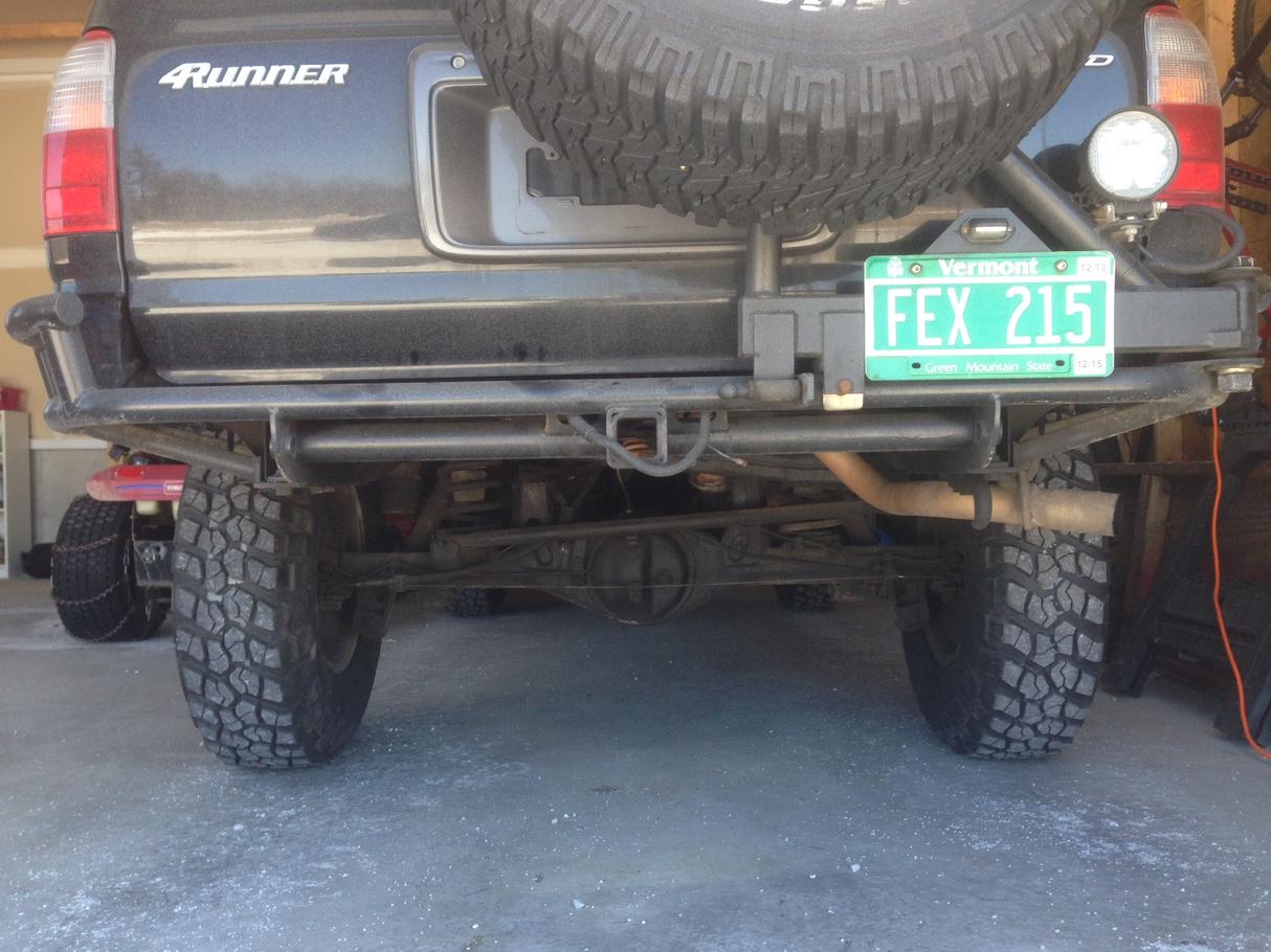

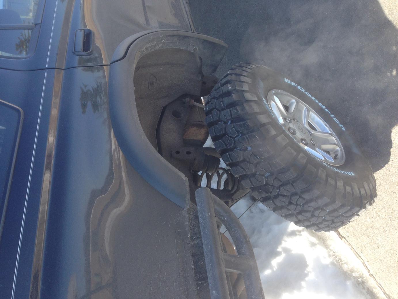

For those that are interested in pizza cutter tire fitment info... Here is my input to the bounty of info out there...
First I personally love the look. The pictures I took are terrible, and certainly don't do the truck/ tires justice.
My set up:
Toytec ultimate lift with the reservoir billies. No body lift no wheel spacers. Junk Yard bump stop mod. Sr5, with the black fender flares, and savage rear bumper with swing out.
Tires that I want to fit:
BFG KM2 (the mud terrain for those that don't speak BFG) 255/85/16
WHY I went with the BFG's:
They were one of the lightest in this size... except for the coopers.
I have had great luck with BFG's in the past.
I actually found a set.
The aggressive side lugs and white letters out help deter the look of huge tire little wheel...(just a thing I have)
Fitment:
They balanced up well
So far I have had to remove the front mud guards, and as you can see below the pinch weld mod is def in my future!
They do not hit the UCA.
They do not hit the gas tank funnel plastic bit
Everything in the rear clears well.
I have very minor fame rubbing at full lock... so minor you cannot hear or feel it(I had the same with my 265/75's.
I believe the only area I am hitting is the pinch weld.... more flexing may be needed to confirm.
4Runner porn below... control yourselves if you are in public!!

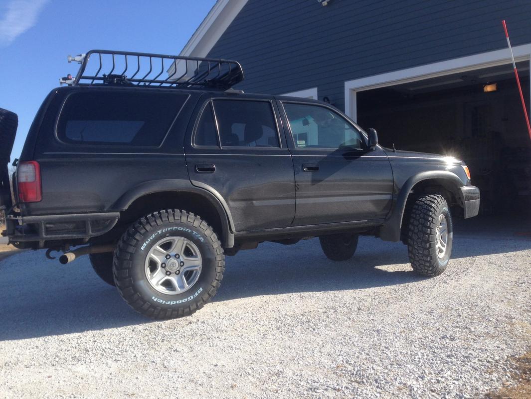

I love my KM2's so far - amazing some of the things these trucks will climb with proper rubber on the ground. I was a little thrown by the pizza cutter comment until I saw the last pic - looks like mine on a serious diet. Have fun out there!
