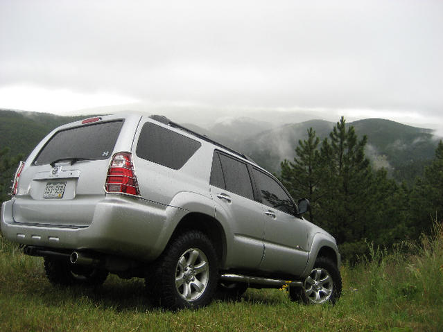

I installed the Daystar 2.5/1.5 a few weeks ago and I have been thrilled with it ever since. The ride is just like stock which is what I wanted. I opted for the Dueler Revo's over the Nitto's due to their reputation and the great sale price I got on tirerack.com...looks like they are still on sale too! I would reccomend my setup without hesitation. Also now I am looking into the Airlift 1000 for the rear to help when I am hauling camping gear and mountain bikes on my hitch rack and hopefully I will be towing a boat soon(if the wife finally caves).
Here are pics of my ride:
http://www.toyota-4runner.org/showpost.php?p=430916&postcount=45

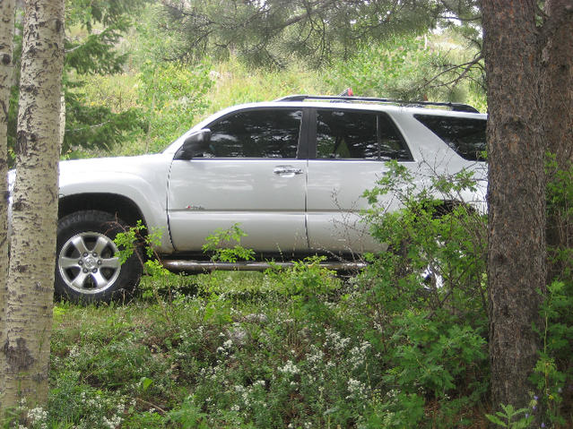

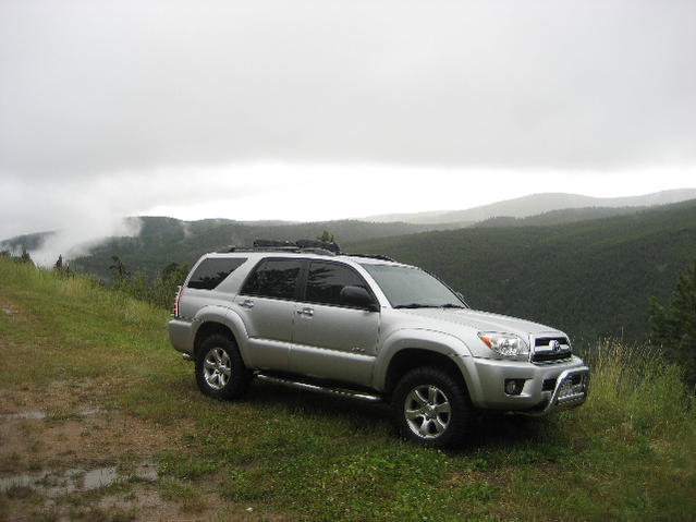

I have a pro comp 2.25" front spacer with 265/70/17 to give you an idea. The ride is the same as stock! I love it but in the future I'll go 3" suspension.

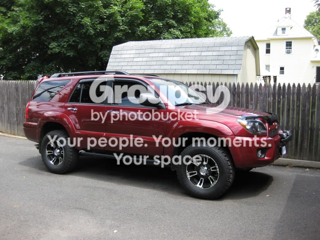

so you all are happy with the lifts.... i like the 2.5 1.5 i think im sold. do you install or get it done?
i did not know if you need a coil compressor. the look great! do you have any more pics of the red one!?
I did the install myself, with a lot of help from a friend. The front driver side took us a while because we had issues with re-installing the upper ball joint, but we figured out where we went wrong and the other side took no time at all. The rear I did myself and was cake. There are plenty of write-ups and posts on installing this lift. I got a coil compressor and a pitman arm puller(for the upper ball joint). The compressors were not required but helped me in reassembly. You should not have any problems if you use the information that is out there. Also, check out amazon.com for the lift, they have the best price...138 shipped. I don't have any more pics at the moment.
