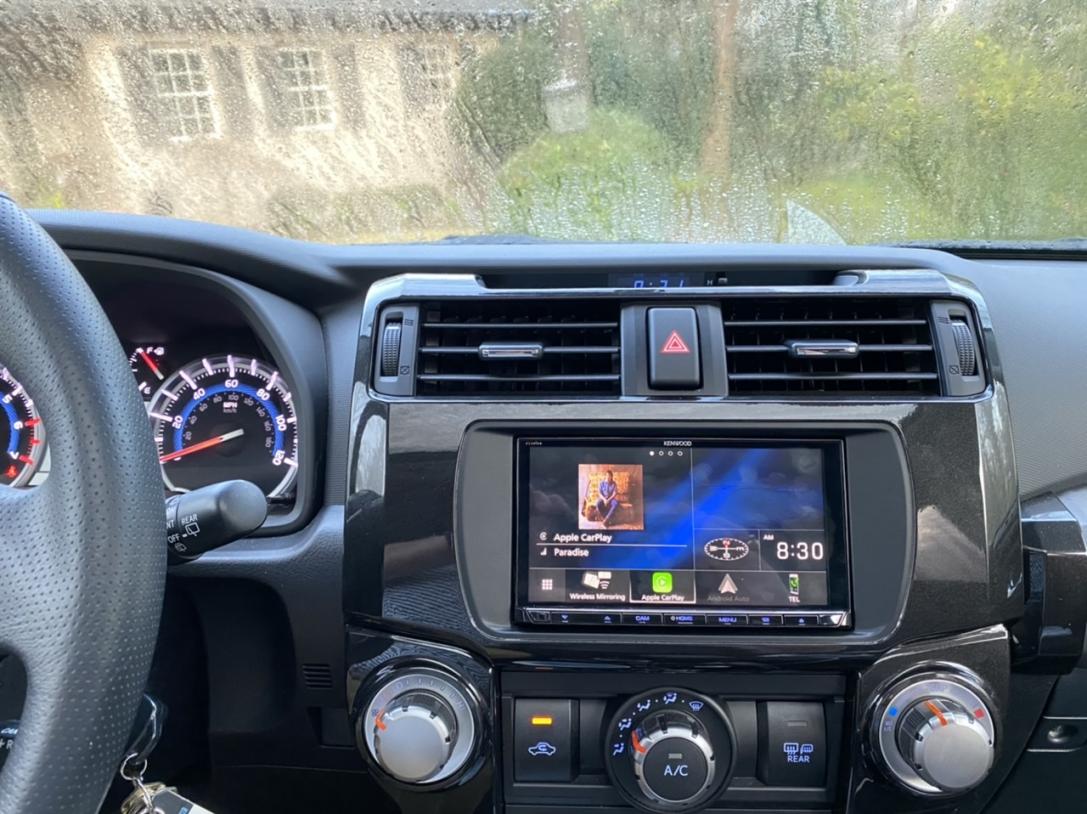

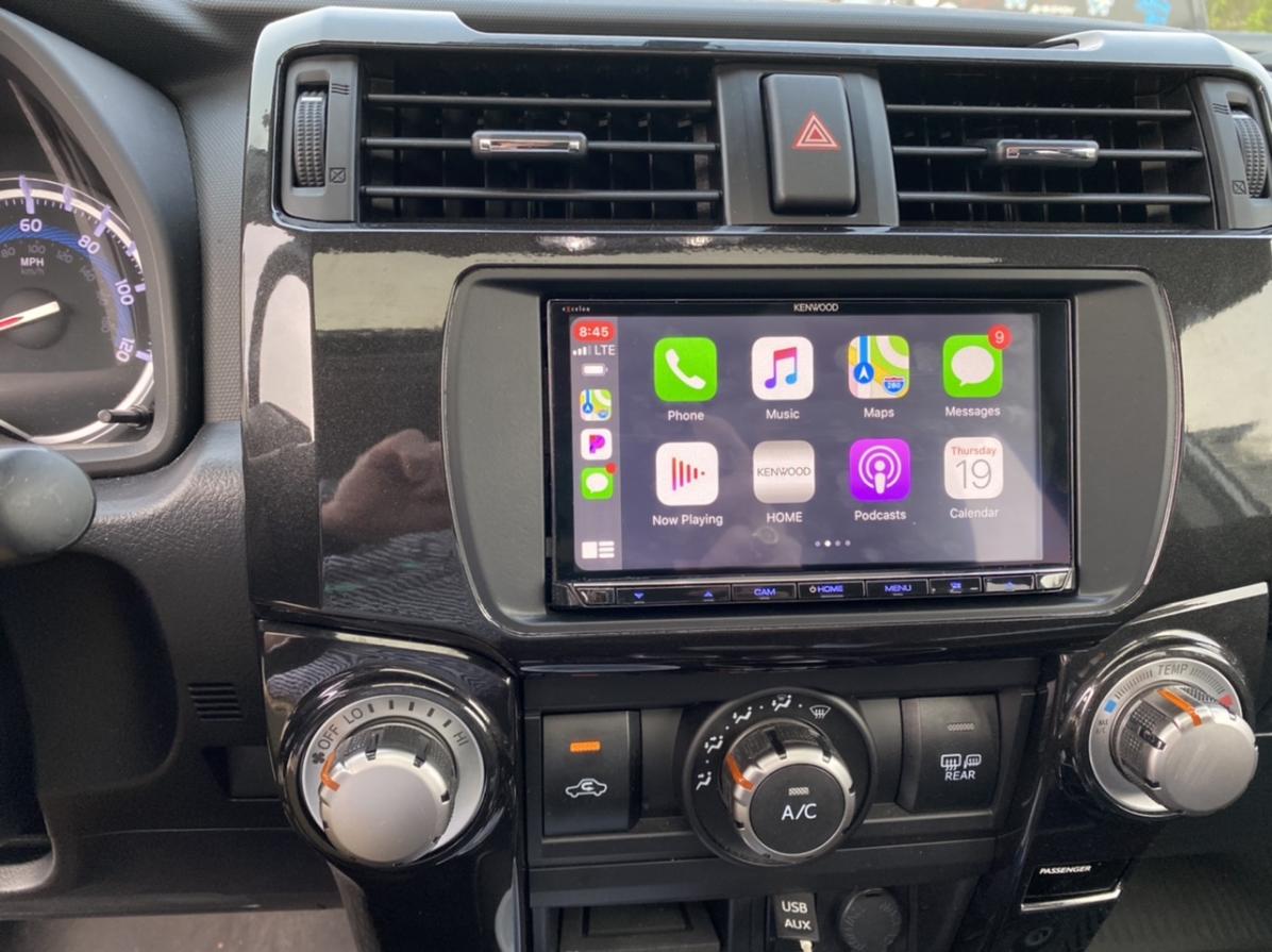

Quick update. I bit the bullet and installed a Kenwood DDX 9906XR head unit with the I-data link maestro for steering wheel controls and obd access for gauges etc.
I love it. Awesome sound, flawless carplay/Siri, tuning capability galore, and no need to ever touch the phone.
I thought I would really miss those big knobs for volume and tuning but am quickly getting used to not having them.

Yes. I have been playing around with the settings. I was testing the USB port and I plugged one in and was unaware that it had some photo files on it. I like that I can throw up something custom if I want. Here are some pictures that look more stock.

Looks good. Where did you get the dash kit for it?
It’s the scosche dash kit. I had it painted to match by a body shop. Also had the recessed bezel section next to the face of the head unit painted flat black like the stock radio. That was worth the effort imo.
