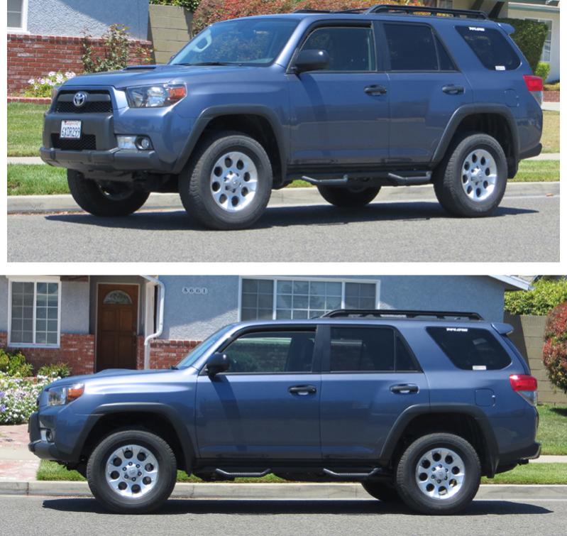

I did 0.85 with air bags in the rear at minimum pressure. Almost level as in photo. 1.75 may be a better level but any load and you will need the air bags. Not sure if spacers would be wanted for 1.5.
