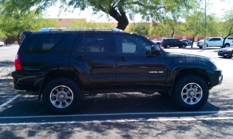

I love FJ wheels
blackfc3s
IMG_2985_zpswt4h6jnn.jpg~original
They should have never made the FJ Cruiser and just upgraded the 4runner.
Looks so good.
What did you guys pay for them? I've been on the lookout for a while but never see them pop up on craigslist or this site.
I got mine off Craigslist for 300 or 350 I think. Got them put them on my truck then sold my blacked out stock ones for 100 bucks. So 250 for new wheels I thought was a steal. And then I just recently did the dupilocor gold/bronze. Just keep looking and crazy deal will show up.
I got mine off of Craigslist a few months ago for $300 with only 325 miles on them. Found a matching one for a spare for $85 at an auto recycler in almost as good condition. I then sold my Limited set of 5 for $600.

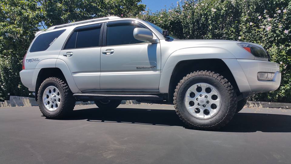

I had plans to put that same style (8 hole) FJ wheel on mine, but I found a set of the 7 spoke FJ Trail Teams (also found on some of the 5th gen 4Runners). I'm happy with them. I have 285/70/17 Cooper Discoverer ATP's on them.
1/4 angle pic here. The ATP's look tame in pictures, but look better in person. Hard to see the tread in most pics, this shows a bit.
What do you have for a lift? I can't decide on 275's or 285's. Looks great!
I like the ones [MENTION=96988]smeagol[/MENTION] has the best. I pretty much like all of them better than my '04 Sport stockers. There are a few deals on Craigslist, but I just can't seem to part with $400-$450 for new rims. I keep finding better uses for the cash.
His post from the FJ suspension thread:
Looks great [MENTION=96988]smeagol[/MENTION]
2007 4Runner SR5
2014 FJ shocks (front and rear)
2014 FJ front springs + Daystar 1" KT09117BK
Sway-a-way 1.5" rear spring
2014 FJ wheels
Cooper Discoverer ATP 285/70/17 E rating
I mixed and matched parts, was going for budget, but quality components. Spent $1480 on all of the above components (340 on suspension, 1140 on wheels and tires). The FJ shocks were Bilstein's (Trail team?) in nearly new condition. I wanted some heavier springs, with shocks to match, for towing and payload help. Haven't driven it much, so height might settle. I pulled running boards, front mud flaps, relocated the front fender liner (redrilled holes), and slightly trimmed the front corner of the bumper.
