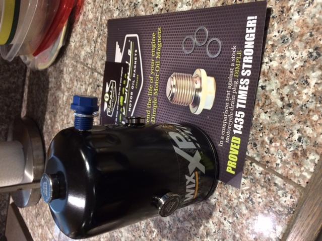

I only use Pennzoil ULTRA Platinum (Yellow Jug now) & new WIX XP Platinum syn. filter.

WIX "XP" oil filters is their new Platinum line / using synthetic media....extended mileage filters.
- WIX Filters XP Oil Filters 51348XP https://www.summitracing.com/int/pa...=pla-google-_-shopping-_-srese1-_-wix-filters
A WIX XP Platinum synthetic filter, is same as Amsoil Filter, re-branded || www.Filter1.com also has good prices.

Dimple Magnets for pan ($35 each) & oil filter (4pk for $35)...quality products & Made in USA...Phone 1-704-320-0700
Canadian distributor in ON. sells them for $35 Cdn & free shipping if buy 3 products...Phone 1-905-665-7883
Magnetic Drain Plugs for Toyota/Lexus Automobiles
