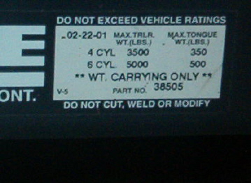

RunnerUP, That looks like the hitch that's on the one I'm going to buy. Does the sticker say "WEIGHT CARRYING ONLY" on it?
My 2001 has a Reese trailer hitch. It says:
Pete, Thanks for the pic. That's the same one that's on mine (I picked it up Saturday). When I called Reese they said I couldn't use a weight distributing system with it. I notice from your profile you pull a pop-up with yours. Does it have a weight carrying or weight distributing hitch?

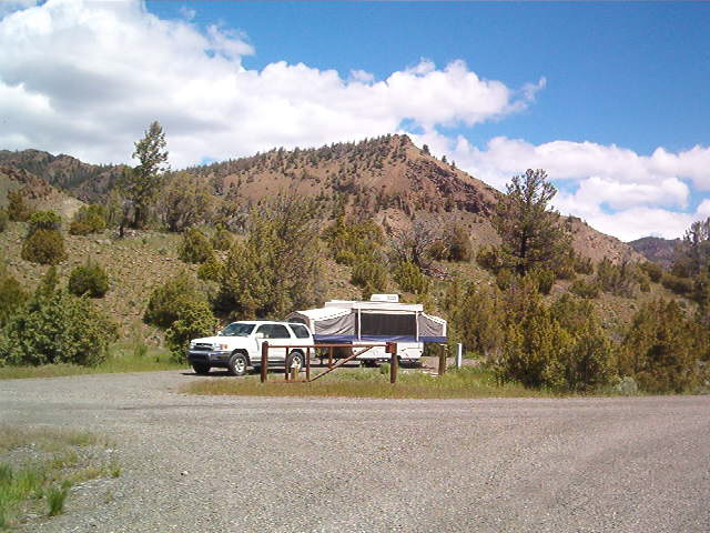

The pop-up is about 1,550 pounds and loaded about 2,100 pounds. It has a weight carrying only. I looked into heavier trailers and they recommended a weight distributing hitch. I stuck with a smaller trailer and may plan going on up to a bigger trailer and a bigger SUV for my retirement, of course the price of gas in 5 years is a unknown and we may be all driving Honda Civics.
You sure get a lot nicer trailer when you go up 4,000 pounds or so, but I wasn't sure if my 4Runner would be happy with it. I took the trailer out west this Summer, went as far west as Yellowstone, WY.

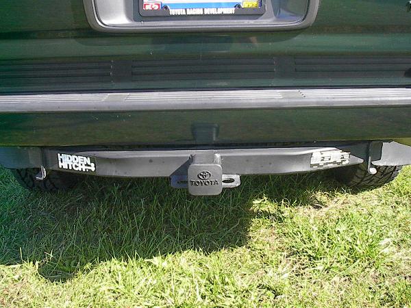

I have the same factory hitch as LEE and it has drooped some since i towed a little with it. looks like it bent down or something.
what is the towing capacity of this hitch as well as the vehicle? 96 limited 4x4
i have seen 3500# to 5000# in various places.
