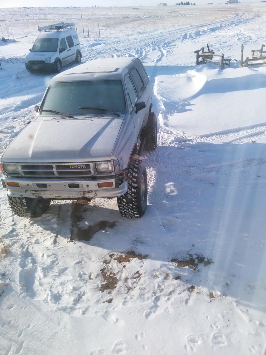

I just picked up this 88 4Runner with a 22RE and when I test drove it sounded great.... after I got it home and drove it a few times I started to hear this really strange noise. I had an 87 4Runner about 5 years ago that also had the 22RE and it developed death rattle and I ended up replacing the timing chain and guides myself, so I thought that it was possibly the timing chain guides on this one also. However after pulling all drive belts and running it and still hearing the same noise and pulling the valve cover the guides are in tact. Is it possible the timing chain tentioner could be wore out and causing a timing noise? The noise is a rhythmic whining/rattling/slight grinding noise. I can take a video and post it to YouTube if that will help. To me it doesn't sound like a knock and I can hear it from all points of the engine and I'm having trouble pin pointing the source. Any help would be appreciated.
The odometer says 222,000
