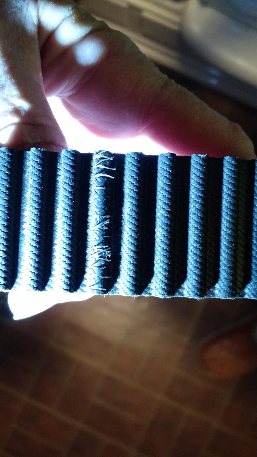

I replaced the Timing Belts just in time.
Dale Bob
I was just about the throw it away when I took a good look at it. I believe it is the original belt with 157k on it. One of the cogs was junk and the cords were broken. Yikes!

Glsd you caught it. I had 200K on mine when replaced. It was definitely past time...it was very "limp". Fortunately it didn't break before replacement.

That stitching present on just one tooth was likely there from the time the belt was new. One of the new belts I bought had this right from the shop. It was either the 88 corolla that I bought OEM right from the dealer, or the 93 corolla Aisin kit from rock auto. Either way, I don't think it's anything to worry about, just something in the manufacturing process. What is the brand name on the old belt for curiosity?

Yes I did the belt, pulleys, tensioner, water pump, belts, thermostat and radiator. I know a snapped belt wouldn't have damaged the engine but it would have cost me a tow and my reputation. I could not tell you the brand name as it was worn off and really cracked on the outside.

Yes that stitching is supposed to be there.
I replaced a Civic timing belt with 300k on the belt. Multiple teeth were only partially there, lots of cracks. That was scary :painkiller:
