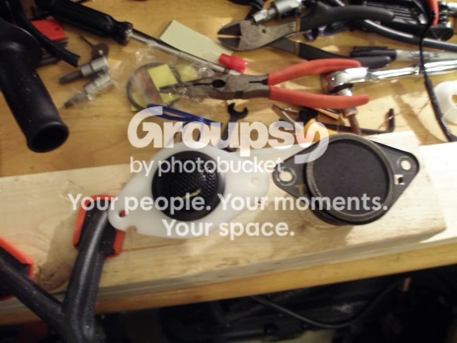

To piggy back, anybody been able to change out the little tiny door speakers?
yes... generally when you buy components they come with tweeters. I installed some 1.75" tweeters on mine. Had to create a custom mount but if you buy 1" tweeters they should fit if I'm not mistaken on the size.
Little speakers? You mean the tweeters?
I replaced them on both my 4Runners
1 Inch Tweeters
3.5" full speakers
