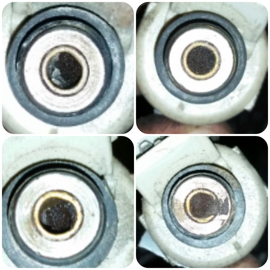

Nah just kidding i know they are, courtesy of a rusty tank and some Gulches offroading (shook all the good stuff loose). Anywho, check this crap out, #2 & #4 weren't getting fuel to the cylinders at all.

Went through the same thing with a 3.0 about a year and a half ago. Makes a big difference doesn't it? I just wish someone designed the intake so you didn't have to take so much off to get at the injectors.
I just had my 1uz injectors cleaned before throwing them into the engine, aside from being dirty outside, they looked pretty good but I still had two that dripped, according to the report from RC Engineering.
Also had a perfect set that looked like new, one was completely clogged at 0 cc/min flow, which is why I always send injectors in to someone to clean and balance them properly, its well-worth the money spent! Burnin' up a cylinder because flow is way down (and allowing the cylinder to run lean) is much more expensive to fix!!!
RC Engineering may be a bit more expensive, but they do a FANTASTIC job and make sure they all balance out to exactly what they should be!
