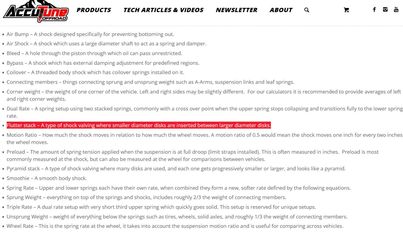

What’s a flutter valve and how do you get the setup you’re talking about? I’d love to know more about it

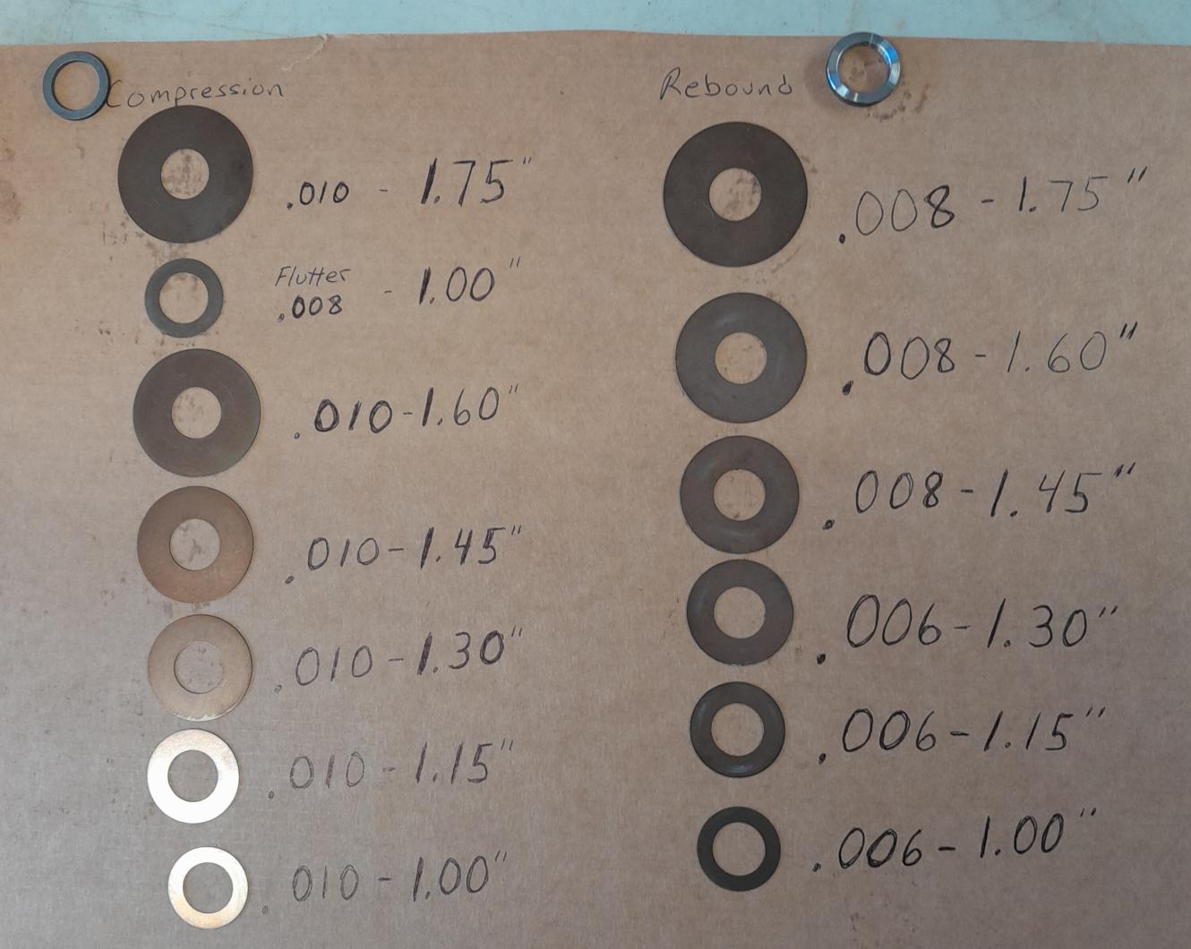

I'm just learning this stuff, and I know there are way more qualified people to comment on this, but here is a picture of a flutter valve set up that I took out of my rear smoothies. It was just too light of valving for the weight I have on my 4th gen. I think there are quite a few variations of this type of setup depending on terrain, driving style, suspension capabilities, vehicle weight, etc. Bleed holes are a thing too. I've read good things about the Fox DSC reservoirs also. Spend a little time on AccuTune's tech page and it might help a little.
  • Screenshot 2023-01-13 at 21-23-10 Suspension Terms Learn & Save AccuTune.jpg
