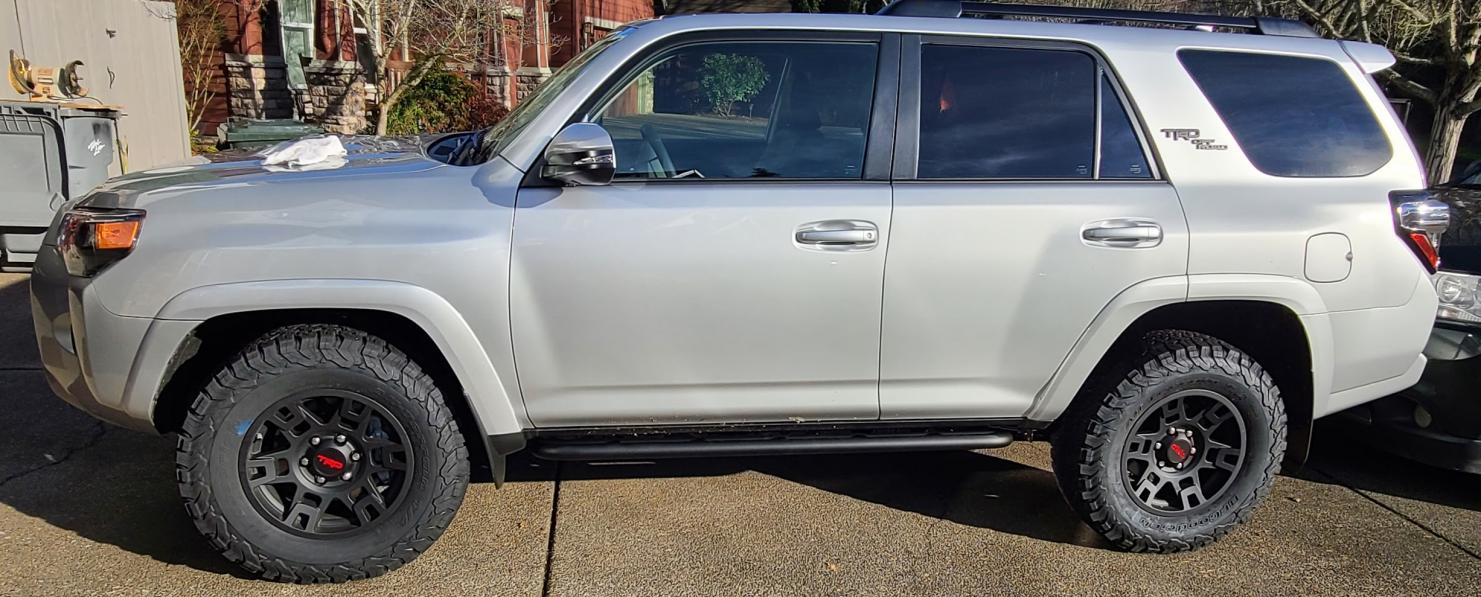

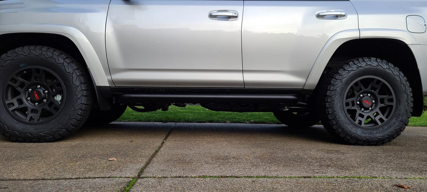

this is what it looks like now.

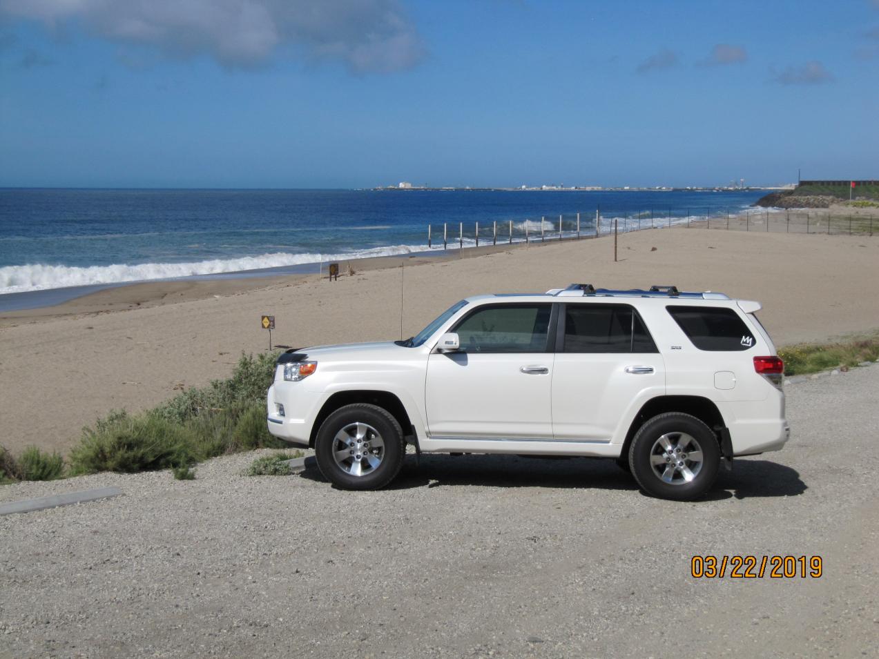

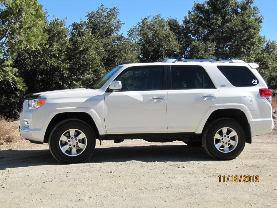

here are a couple of pics of the lift the beach shot still has the SR5 rocker panels the later shot has the trail rockers installed which makes it look a little taller but the suspension is the same in both. the tires are the OEM size Michelin Defenders.
I don't think the drawer system dropped the rear end any more than a third row seat would May be a 1/4" but it was not noticeable . I don't have a third row seat so I can't tell you what it weighs.
