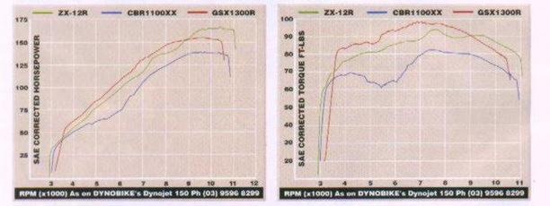

I know this is a mistake and I said I would not reply to your posts but maybe you will be man enough to admit you may not know it all. Anyway, this chart will show the difference between a bigger engine tuned for lower rpm power compared to a smaller engine tuned for higher rpm power, yet both produce almost identical performance. The Busa is geared for 196mph and the 12 is geared for 200mph.

Looking at the torque graph, I just can't see how these machines are completely different in their power delivery. If you said the 1100XX was completely different I wouldn't argue, but the 12R and Busa's torque are always within 5%-10% of each other across the entire RPM range. Factor in the gearing difference and it's more like 4% to 9%.
About being "man enough", I guess I don't know what to say because I'm not sure what I should admit to. Give me specifics. Show me the error in my silly statements and I'll gladly fess up.

If you look at the Busa's HP curve you will see that it makes 5 to 10 HP more then the 12 up until it peaks at approx 8500 rpm which is directly proportional to the approx 10lb.-ft. of torque, which peaks at approx 7000 rpm. This is a result of 100 more CCs, a small bore & long stroke (81mm X 63mm) engine.
Now look at the 12, the HP curve shows that because of its design/tune it sacrificed HP & torque in the low and mid rpm range for high rpm HP & torque. Where the Busa
