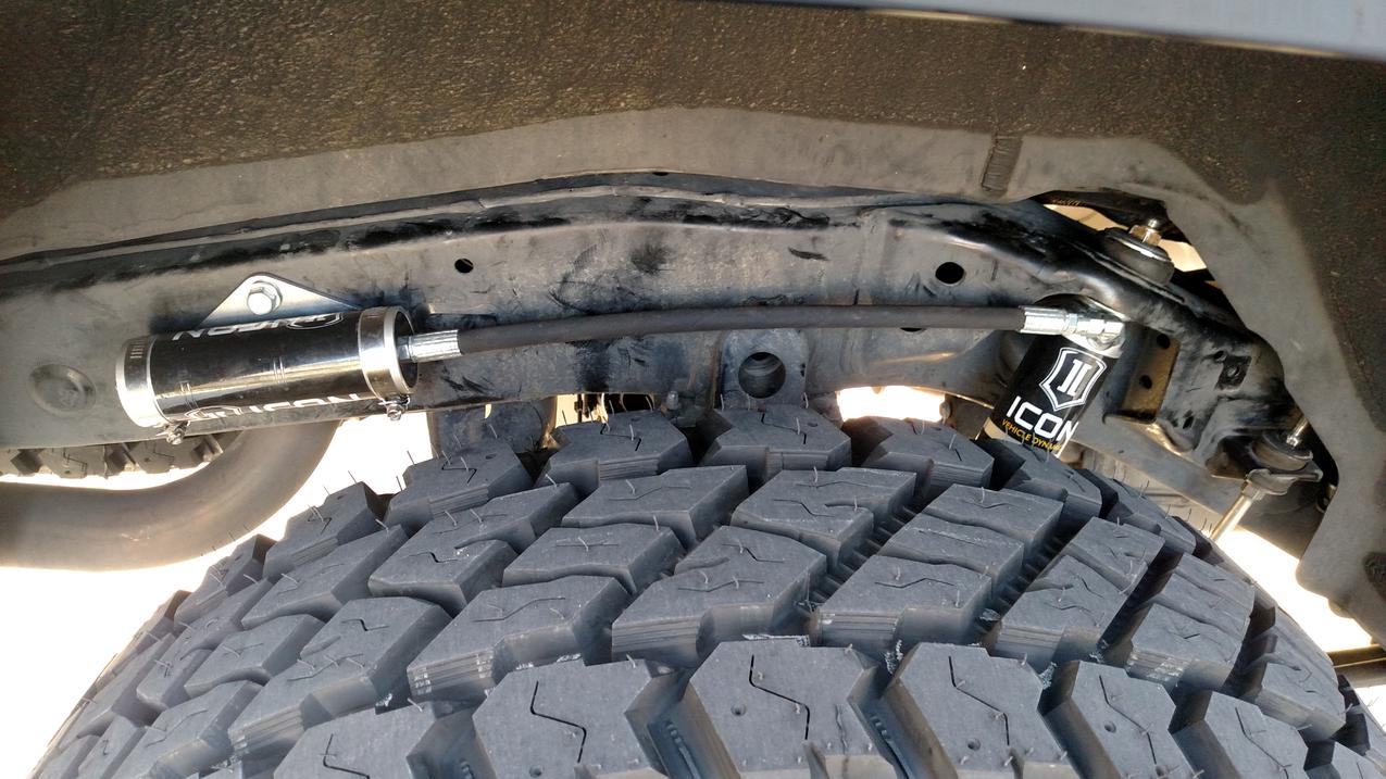

is that hole just forward of where they're zip-tied threaded? i'd use that to mount the reservoirs, and then install the hose-hanger so it sits right up along where the body meets the frame, as you can see in LawnDart's pic.
EDIT: does ICON not have install instructions for these? i've never seen them before now, so don't know if mounting them as i just described would put them too far into the wheel-well.

Here's the final photo to those who helped me. What do you guys think?

did you ever contact ICON to learn exactly how they intended them to mount up?
so long as there's no contact/rubbing on the reservoirs when the rear wheels are fully stuffed it's probably fine.
