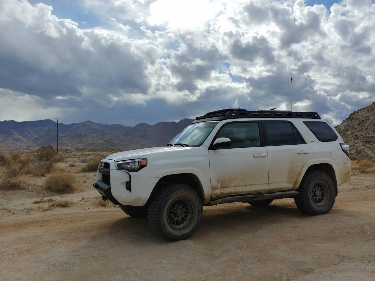

Hadn't seen your post before today. I am running an Icon stage 1 with SPC UCA's. However, I have a 1/4" spring spacer on my driver's side rear to offset the driver's side lean.
Before I leveled off my truck, I did not notice any sagging when my rig is under load. I just don't like the reverse rake look so I would notice that right away.
I've got RCI skids, C4 sliders, a winch bumper/winch, and aluminum rack, plus whatever I load up for an overlanding trip. I've attached a couple of pics of my rig under load and it appears to be fine.
Hit me up if you have any questions.

Your winch and bumper would really help to counter the weight in the rear.
Mine is all stock except suspension and brakes. The majority of the weight is in the rear.
